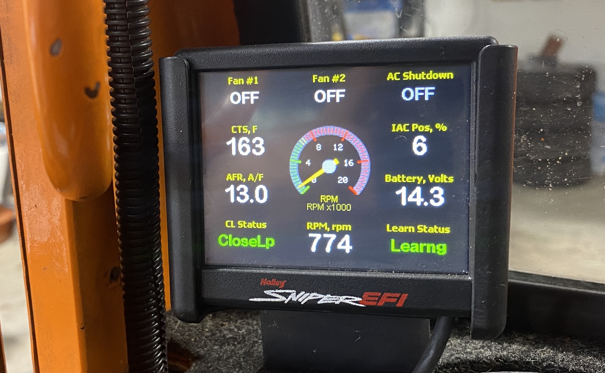

I put a Holley Sniper EFI on my Dodge 318 and it purrs like a kitten and is real snappy. Starts easy and runs smooth even when cold or wet out.
Big learning curve putting it together. Reread the instructions and it works best when you follow those.
I have a car with the Sniper on it. Junk for me so far. The car refuses not to overheat when run for any length of time.
Supposedly the original was not good at keeping stray electronic interference from the ECM.
Holley now has a Sniper 2 out in the marketplace. They have now divorced the ECM form the throttle body and mount it separately. I think this means they knew they had an issue in some applications. If I were I to do it again that is what I would do.
