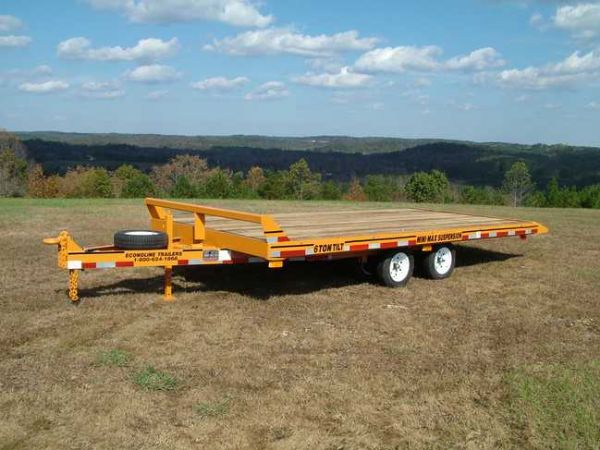

I saw one of these in Berlin, NH last week. It was hauling a couple of antique horse-drawn plows, probably to the Lumber Jack Festival that's going on there this weekend. Anyone have any experience with or heard anything about these trailers? I need something bigger (higher GVWR) for my Thiokols and really like how low these are as well as the the minimal tilt angle. The axle/tire arrangment is new to me. A good or bad setup for hauling on snowy/icey/sloppy roads?

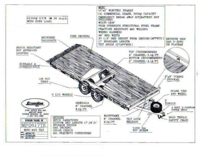

http://www.econolinetrailers.com/TrailerSpecSheet.asp?TrailerID=1
