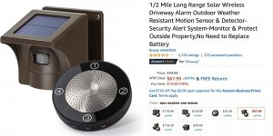

This one I got from Amazon for around $70.
https://www.amazon.com/gp/product/B07L3TFM2G/ref=ppx_yo_dt_b_search_asin_title?ie=UTF8&psc=1
Customer service was rated quite highly, as well as the reviews.
It's quick and easy to set up.
I chose it because it's said to have a half mile range (line of sight is critical).
Also because it's not primarily a motion sensor, but a heat reading motion sensor, which means that whatever source triggers it must not only have motion, but heat, such as a vehicle engine.
There is also the ability to have a total of 4 sensors working off of the base station with a different musical tone for each.
One of the biggest selling points for me is that it's solar powered.
Unfortunately, living creatures such as range cattle will set it off.
Since it was line of sight, I placed it right at the bend in the "L", with a clear shot to the house.
It works fairly consistently to a point, but has a number of false alarms throughout the day, possibly birds, who knows, but false alarms are unacceptable to me.
I also noticed that at first it wasn't working during particular times of the day.
I contacted customer support.
Their immediate response was to send me a new unit.
I was quite impressed when they sent it overnight shipping.
After some experimentation, I found that steep hill across the drive from where I had mounted the sensor was getting so much sun and heat during the middle of the day, that it was obscuring the sensors ability to detect anything.
I told customer service this, but they still insisted on sending me a new one.
I eliminated the heat problem by changing the angle on the sensor, and the new sensor still sits in its box.
But either way, there's still false alarms, so I'll find a different application for it somewhere.

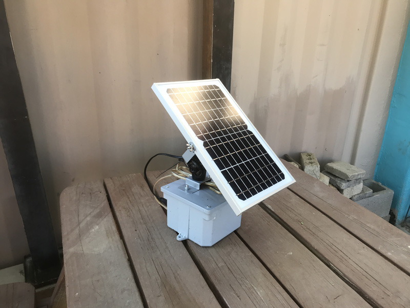

One thing I find rather surprising, being as that we are in the age that we are, is that this thing isn't a bit more sophisticated maybe having some bluetooth capabilities with alerts to your phone etc.
One other slight drawback, it that the transmitter is battery powered at 12VDC, requiring 4 rather expensive CR123 batteries ($10 set).
The battery life is projected at 6 months, which is fine, but what good is the thing if the batteries die and you don't know it?
They don't offer a solar power solution, so I built one myself using a 12V 5ah battery, a PVC junction box, and a 12V 10 watt solar trickle charger, which I'll have to wire into the unit.
The solar charger was about $60, the battery $20, and the box $15.
I discussed it with tech support, and they're ok with it, and said that if I had mentioned I was going to do that, that they would have gladly wired in leads for me before shipping.
