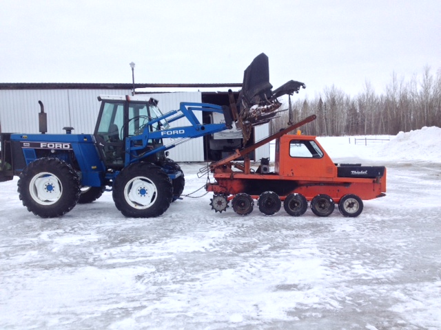

As previously posted looking for advice what to do with these 2 old cats, the local Ski Club approached me to make them an offer on them. They accepted my offer, I'm not sure that was a good thing, but I'm about the only one who was willing to remove them. Any way I managed to get the Thiokol myself by removing the tracks and towing it home with my tractor. My son offered to bring an rig mat down and winch the DMC onto the mat with one of his trucks and haul it home. I couldn't refuse. We only had to haul it a mile so we didn't worry to much about the local over width laws. The school bus driver did sit at an intersection and wait for us to go by. I plan on putting a little effort into them and running them thru the Ritchie sale in September. Other than a little neglect, they're not really in that bad shape. I'll have to splice the tracks on the DMC, but here in the Alberta oil patch that's a daily process.

This model has a Ford diesel, before they were bought out by Ford they were Cummins, before that they were Wakasha. The 3700 wasn't parked because of the front axle. Here's the real storey, the ski club bought the Thiokol in 1971 from a bankrupt ski hill by Calgary, Alberta. They used it to pull rollers until the late 80's. They then bought the 3700 for $72000.00 and parked the Thiokol in the shed. They used the 3700 until about 2000, when they ran the wheel bearings out of 2 wheels on the left side. Benign the experienced operators they were they ran it until both wheels came off and got jammed in the track, splitting2 belts on one side. They then parked it int the same shed as the Thiokol was in. A few years ago they bought a PBS 200 with 12000 hrs on it. 4 years ago the room fell in on the shed storing the 2 cats. They got the 3700 started and drove it outside, they towed the Thiokol outside. There they sat until a month ago. In there wisdom they tied onto each of the cats, while they were froze down and basically tore the track and front spinal off the 3700 and tore the front spinal off the Thiokol as well. Now the PB 200 has lift pump isuses and I've rolled the hill twice for them. At there present rate of wrecking stuff Ill own a PB 200 in about 2 years. I believe someone said on this forum that these machines should be looked after like an airplane, I do believe they do need some care or else they end up like these ones.

Just an update: I found a fellow on Kijiji looking for a wide track snow machine. Sold him the old Thiokol and I did very well. I drained and changed fuel filters in the 3700, gave it a boost and the straight piped John Deere roared into action. Runs well and everything works, from heater to the tiller. I guess I have a little work to do on tracks, axle and a few cracks. The wife thinks it would be fun for her to play with. I think it's a source of cash so I can buy another Tucker.
