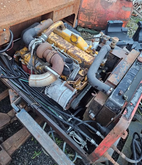

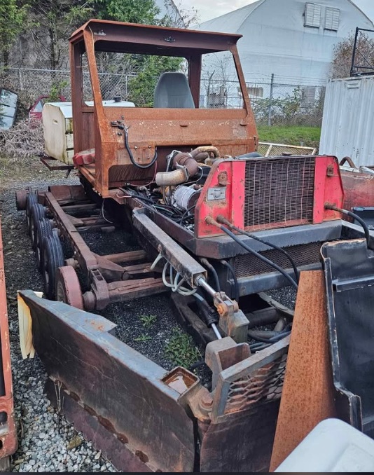

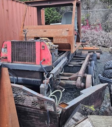

Hello, new to Forums,have read almost every snowcat posting. Thought this might be the best place for opinions on this DMC 3700.
I was looking for a new project and thought a snowcat would be fun. Have come across this unfinished project that I could handle.
Don't know if there is any value in a restored 3700. After an inspection and from reading posts here, some observations.

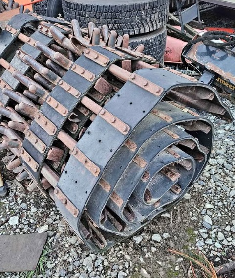

The previous owner made a new cab, wider to seat 2,it needs doors pass and wiring insulation etc. The sprockets need recovered as wells the front
urethane wheels. Bogies are so so, some good some no good. The Allis hasn't been run in a while. The drive train is complete with a 6 way blade.
Any thoughts?

From you asking about value... If you are thinking about making money "flipping it". The lottery has a better return rate. If you're thinking about a fun cat and using it for a while then that's different. My opinion only.
If you can handle it, go for it. The allis is a simple engine. Most are snowcat versions are intercooled.
Most died from being over revved all night at the hands of operators who didnt care.
Tracks and idlers are the easy large work items.
Pumps and hyd motors are simpleish.
They are heavy and strong.
I cant move them around easily so i stay away from them. I buy them if they are cheap as they are great parts pigs.
Ive had two. I like them.
