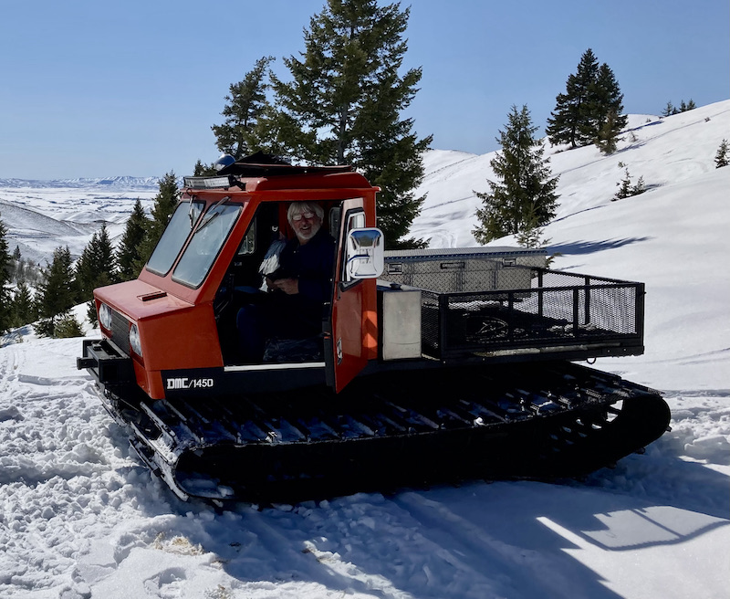

Here’s a pic of The Infamous WBJ1 and The Wonderful Jenn, taken at SV 2021. Note: it really wasn’t that warm... The Infamous WBJ1 is just part polar bear.
