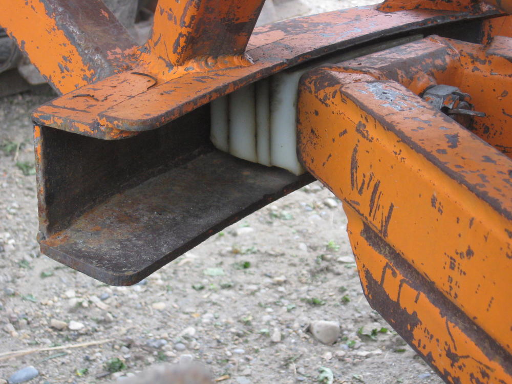

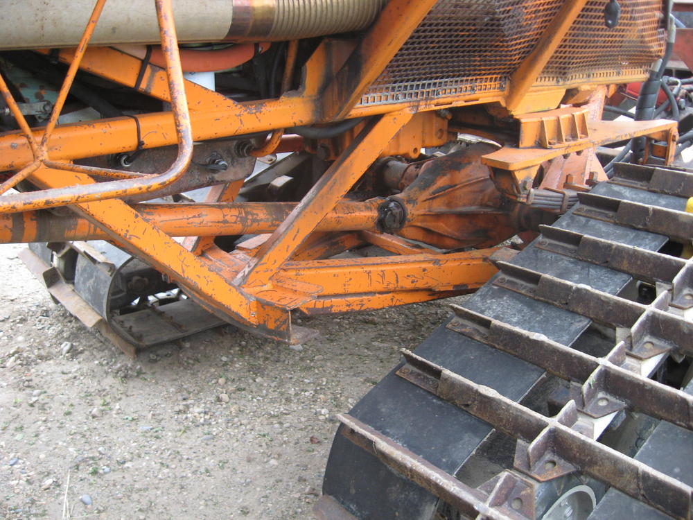

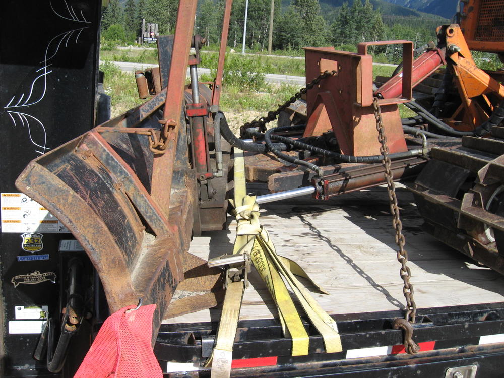

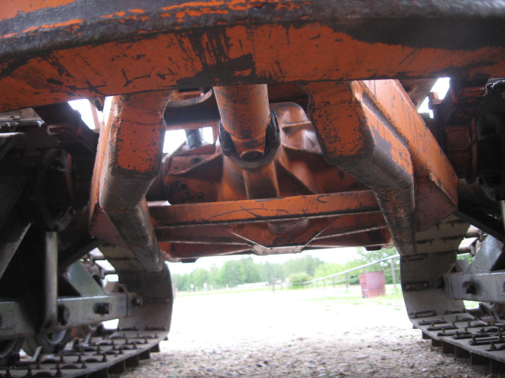

I'll get you some good ones tomorrow. This will tempt you and get you thinking. This is my 1642 but that doesn't matter.

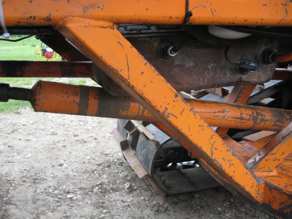

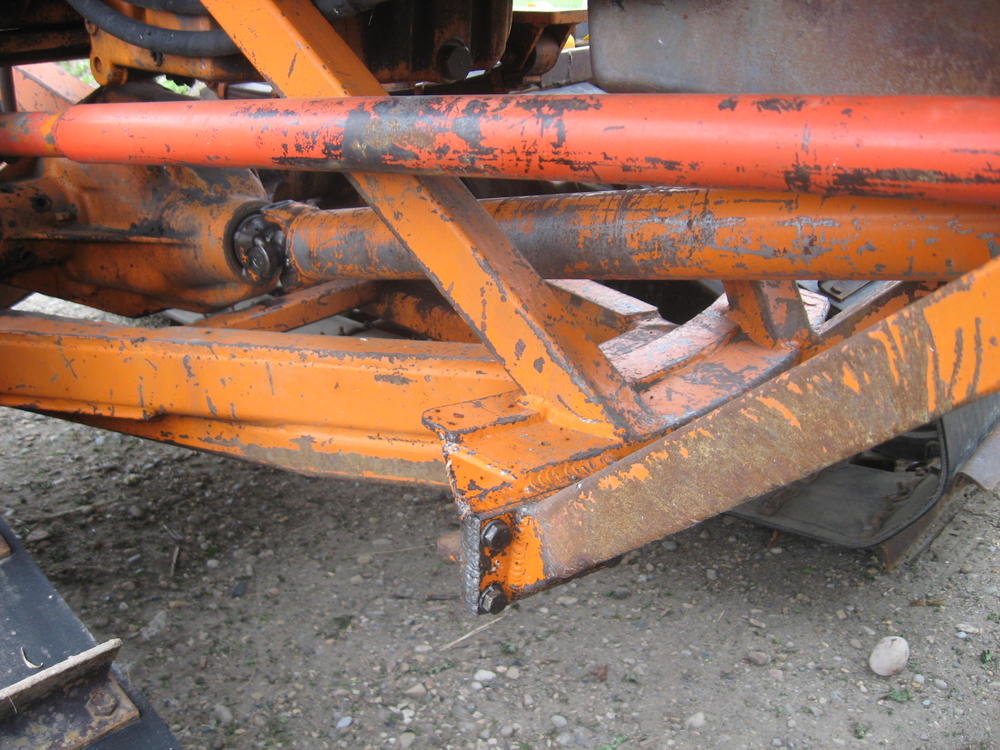

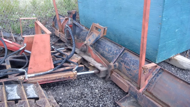

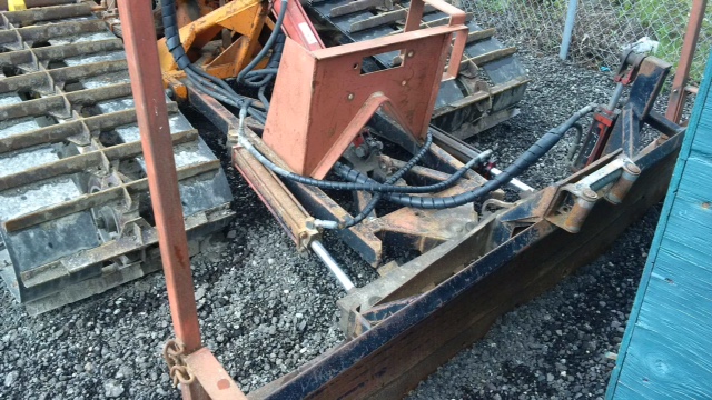

Here you go, hope it helps. My blade seems to be a long way out in front, when you look at it. but it needs to be for clearance. Blade visibility sucks, that's why there's the square tubing uprights sticking above the hood, so you can see the blade position. More to come.

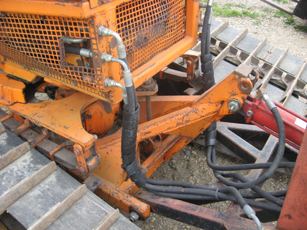

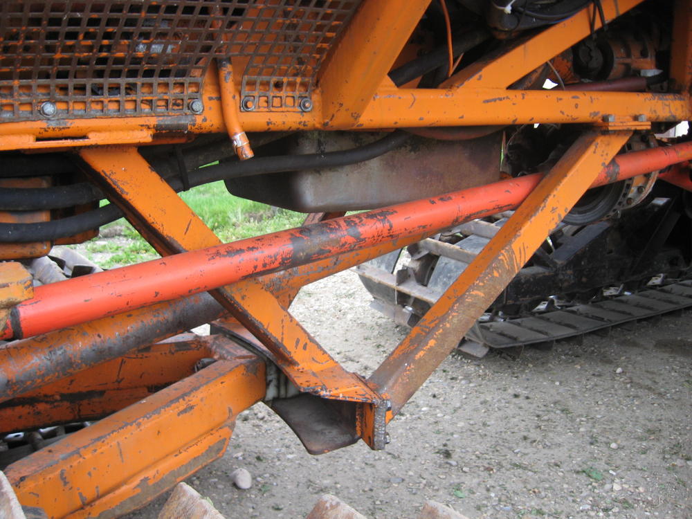

Here's the last ones. Notice the winch mount and the roller fairing on the blade. Let me know what your welder thinks, not much work here in the Alberta oil patch and my 1344 is sitting in the shed beside my 1642, I could maybe build you a system to fit the 1344. But if you need anymore info or measurements don't hesitate to call 1-780-514 0753. This is a great site, info and opinions always free. Randy:biggrin:

Randy, what is the distance from the blade to the front of the Tucker where the blade frame mounts to the under the cat frame? TIA
From were the under the cat frame (orange) and the blade frame ( black) are bolted together, to the dozers center pivot pin is, measures 54". But you are working on your 1344 which has shorter tracks, so I measured the distance from the front of my tracks to the same center pivot pin, which is 25". You don't need your blade so far out front. Also were the orange and black frame bolt together is 4" in front of the grill. My only concern would be how high the blade lifts. I sent you a PM last night, did you get it? If you need anything else, let me know.
