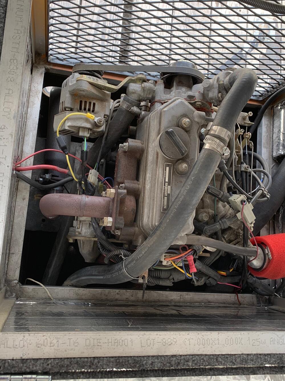

Does anyone have experience with changing the final drive gear ratio on a Cushman Trackster when upgrading to a lower rpm 4 stroke engine? Looks like the old supplier of the parts and conversion service is out of business.

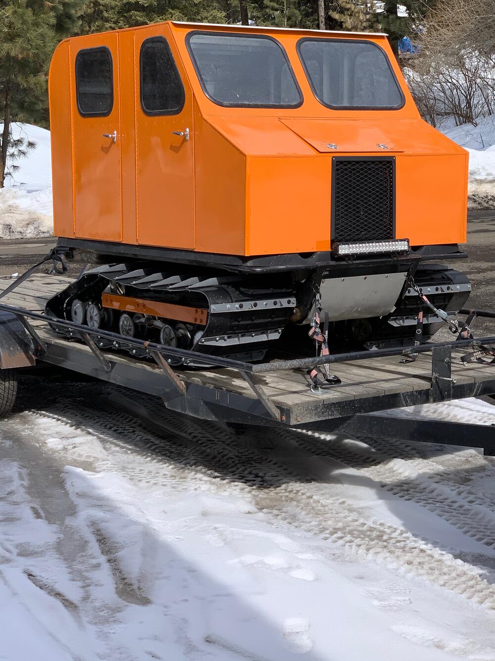

Our Super RestoMod Trackster

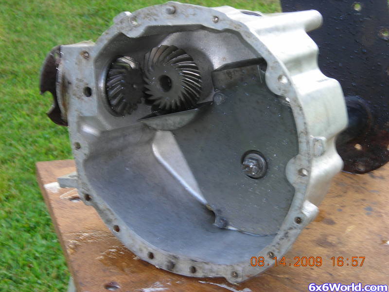

Looks like i have found the source for the new higher ratio pinion gears for the 4 strike conversion. Anyone know if pinion gear service, shimming and adjustment is covered in the Trackster shop manual?
Just found the gear set that will change the engine speed to pump speed ratio from 5500/4200 to 3500/4200. Perfect for my Trackster's little 4 stroke triple.:thumbup: Maybe room for a tiny turbo? :idea:
