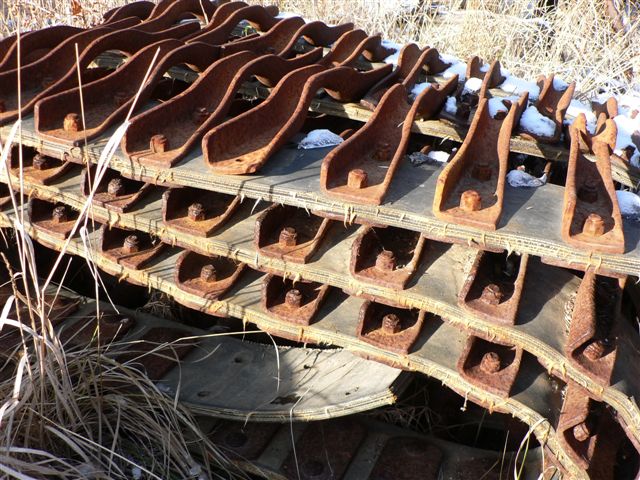

I have a spare track from a Bombardier muskeg with the double detent track the crossslinks and belting are in good shape. Can I use this style of cross link on my bombi with the proper spacing or are they to heavy? They are also the same cross links used on the bombardier snowbus.I have winter tracks on the bombi but would like summer tracks.

Here are some pictures of the crosslinks I was wanting to use.

Maybe I would be farther ahead to sell this track. Any idea what a used track would be worth? I was told it would fit a bombardier m-6
We have 2 sets of Standard summer tracks for the Bombi in new condition, price $2,000 per set your choice, FOB Weiser Idaho .Call Bill 208-549-2501 This may help you with your price for the Muskeg track.
I would not try to use those on a Bombi we have 6 sets of new Bombi tracks ready to go on your machine we would trade a set for your muskeg track
that is a very old style track those cleats will work on a Bus but are not the standard cleat those are the same as a J-5 cleat
