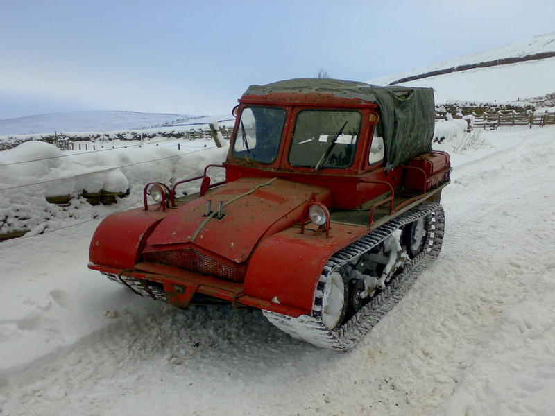

My coil overheats and breaks down on my ex military 24v snow trac, as it is 24v I cant find a replacement coil, but I am just wondering if the custom exhaust system I made could be causing this problem, I have 2 silencers running vertically and coming out of the bonnet, could the extra heat from these be causing the problem? I dont have an underbonnet photo to show you all the exhaust but here is an exteriour pic to give you an idea. Thanks

John, I have my exhaust exiting out the front of my Snow Trac and do not have any problems with overheating. I doubt if your vertical stacks are causing the problem. JMO

As for the exhaust system you show, I would say it's not ideal for controlling heat in the engine compartment. For the car, VW engineers routed the exhaust out of the compartment, and sealed the compartment with tins and a rubber gasket. The stock snow trac configuration is a compromise on that design to begin with, and further modifications like routing the exhaust up through the engine compartment are a greater compromise yet. But how hot is too hot? Consider that your coil temp is largely a product of the heat it generates added to the ambient temp of the surrounding air in the engine compartment.
