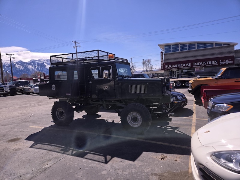

Well, WBJ1 found a company in SLC that did dyno tuning. The only problem was their dyno wasn’t set up for snowcat tracks. So, The Gorilla and I removed the carriers and tracks and put CHUGSzilla back on wheels and tires so they could run the machine on their dyno while making programming changes. “While we had it apart” WBJ1 asked us to change the sprocket drum fasteners to the same setup we had recently upgraded Thundercat to. We also used the 60º chamfer bit and modified the sprocket drums for conically shaped lug nuts.

Here’s the ugly green machine back on tires at the dyno tuning company.
And on the trailer behind Scott’s truck.
