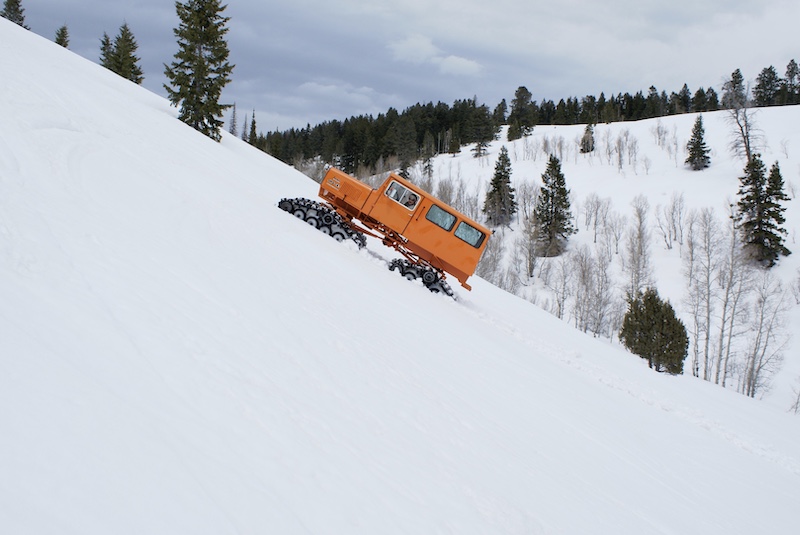

But today CHUGSzilla made it to the top, and did so without question. Though it's equipped with Eaton E-Lockers in both front and rear axles, the E-Lockers weren’t even needed. I don’t know why but the video of the first attempt did not turn out well. CHUGSzilla made it 98% of the way up... and then spun out. The (successful) video that follows was a different line up the hill. In the second video, going down hill, at the 5 second mark you can see where Scott spun out on the first attempt up the hill.
Going up: https://www.youtube.com/watch?v=1Aj_jpGaijY
Going down:
To take the driver variable out of the equation, Scott made three tries with the 1544. This is the best of the three.

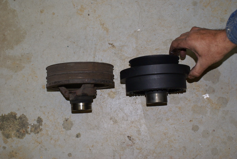

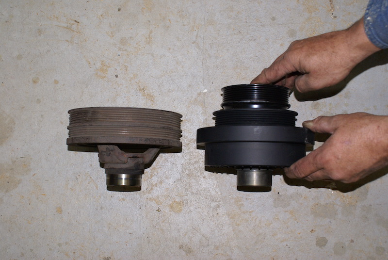

Pics are always helpful. The stock 8.1 automotive balancer is on the left and the industrial version is on the right. You can see how the industrial balancer is machined to accept an auxiliary pulley.
Here’s another view. Note the smaller diameter of the machined groove area on the industrial balancer. That means the water pump, alternator and power steering pump run at slower speeds than they would with the automotive balancer.

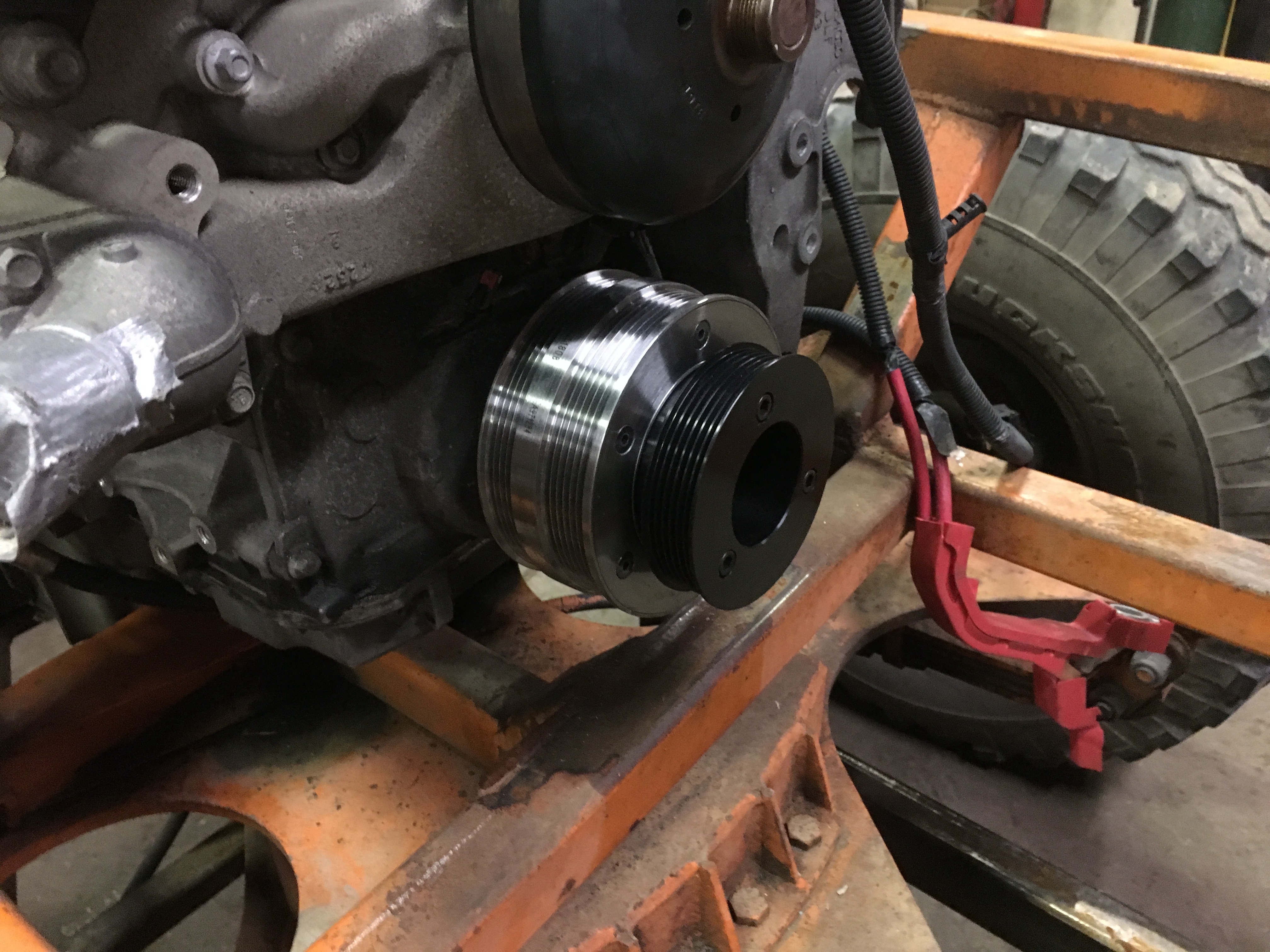

Here’s Scott holding the auxiliary pulley in position.

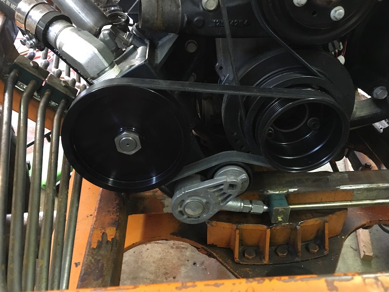

And here’s the installed setup on Thundercat’s 8.1 engine.
Here’s the setup on CHUGSzilla.
