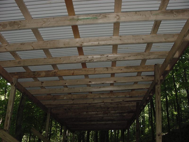

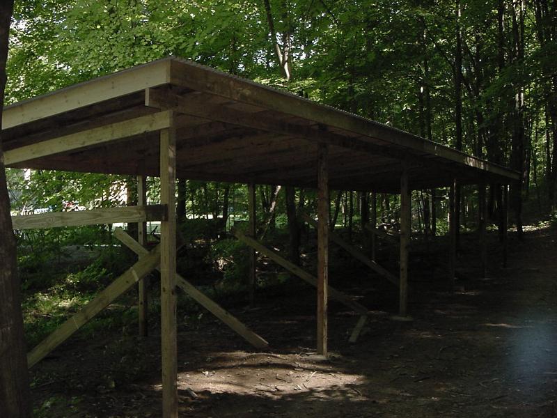

It's been a couple years, but I stick built a long, narrow building and was able to complete it (but only a stone floor) for about $4 sq/ft.
Here's a couple pics.

Brian , Nice job . From looking at the pics, I'm guessing the columns are 4x4 . Right ? As it looks like You took the time to cut the rafter tails, What pitch is the roof ? Did You get Your roofing from a box store ? And lastly how did it affect your property tax? being as it might be considered a permanent structure , I would be interested . Sorry for all the questions . But my 12x12 enclosed wood shed that I built this last summer has proven too be way to small .
John,
Yes, the posts are 4x4's, 10' on-center. I made it into 5 bays.
The roof pitch is either 1/12 or 2/12. I honestly don't recall.
I got the roofing from Flexospan in Sandy Lake (up your way). They had some "seconds" but I honestly couldn't see/find anything wrong with them. I got them for about $15 each (3x12') which is about 1/2 price.
The exterior is hardy-panel.
3 sides are walled in. On the 4th side, there's 5 open bays. I only have canvas tarps on that side that roll up when I need access.
My property taxes went up approx. $15 per year.
