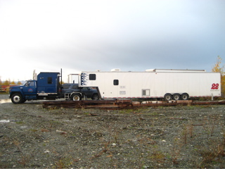

Okay, for those who have been patient, or who care. . . here is my solution to the problem. I may start a new thread . . . this is how you pull two snow cats at the same time:

Unless you have a snowcat that is 8ft6" wide. No enclosed trailers for those...
Nice set up. May limit you in a few areas (parking) up here but that just means you'll get to drive the cats further...
Had to promise the wife I would install a jacuzzi in it, correction, & dimond earrings, correction, the list is growing.... Just barely fits 8' inside door and 7' between wheel wells. Parking, well that a whole other thing.
