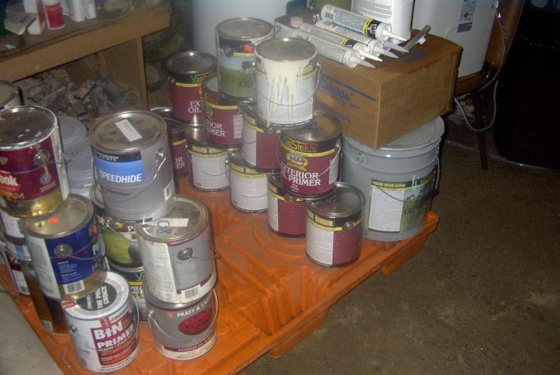

In a few minutes, I'll head down, kick in the pumps and assess the damage above; the basement isn't finished, so, if the furnace and breaker boxes all survived [looking positive on the latter, only even shut off the former] only paint cans and "stuff" will have damage rather than walls etc. However while waiting for the dripping among overhead lines and chases to stop, had to share with everyone here, so you know that according to the Law of Conservation of "$h!t Happens" you'll all have a great Monday! Enjoy! :tiphat:

On the paint cans, make sure you get the bottoms of the cans very dry. If not, they can/will rust out. Guess what happens next time you lift the can? Don't ask how I know... :hide:

Thanks for the advice on the paint cans bczoom! I had them on a plastic pallet so they should clean up easy but noting your experience, think I'll be opening that cardboard case and drying them as well.
For irony, my 36" pipe wrench and the dehumidifier were among items that got wet. :biggrin: Just exterier wipedown with a little WD-40 added to the former, and a some drying time added to the latter, I think they'll be fine. The furnace looks like it was just exterior, but I have to pop a couple panels and check the control board before I want to turn it on.

Let things dry up a bit and the furnace is fine; the paint cans were on a fairly high spot so, with the pallet's height, survived the flood well, and the dehumidfier acted as a nice splash guard too so only the lids got sprinkled and only had to wipe the bottoms on a few.
Some plain junk got buried in mud on the lower corner, but that is a good excuse to remove it, so not too much real damage. The plastic tubing, however is even less promising than I hoped, so going copper isn't on the "someday list" anymore. :bonk:
