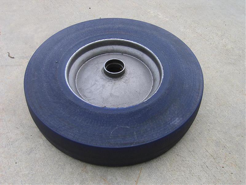

Here is a picture of the solid rear wheel-tire for a Bombi,BR100 ,BR100plus
4.50X10.00 this is a mount it and forget it type wheel.
Also a front sprocket of the same material :thumb:
We can make these types of tires for any machine we now are making some for a 36" wheel.

Thanks loads guys I got the rear original bombardier tires filled. Heavy suckers but it will work great I'm sure. Thanks to this forum and it's members for the help:applause: :beer:
