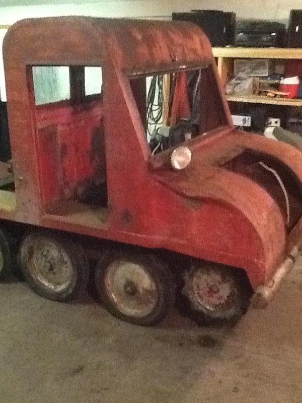

Just got a bombi track machine don't know year or model any help ?

How many wheels on each side ? How wide is it ?
A picture of the whole thing would help.
Could be a J5 with a custom cab/body.
It is 5 feet wide and 9 feet long it has three wheels I will try to get more pics. Very new to the forum still learning how to use. No tags any I can see
Those are the dimensions of a J5. If it's exactly 60 inches wide, it's from the '50s or early '60s. 64 inches is a newer model.
What thickness is the metal in the tub area > that is the area next to your shins/under your feet in the driver's seat ?
What kind of engine does it have ?
It is just under 60 " and the metal is 1/16 thick it has a flat head 6 in it and a four speed manual trans
Sounds and looks like a late '50s J5.

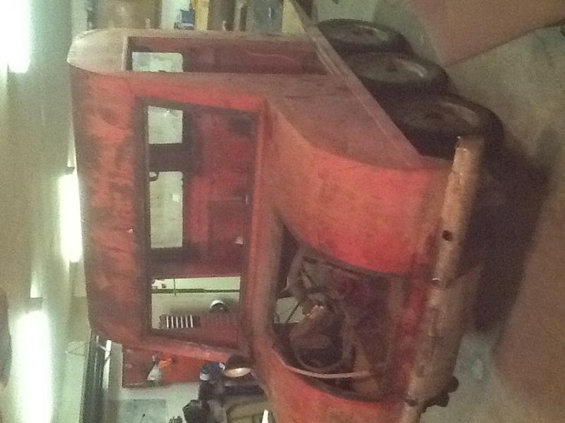

Do you have the tracks and engine housings ?
Does it run ?
What are you going to do with it ???
Yes I have tracks and housing rubber is shot but cleats are great . Working on restoring it.
No motor does not turn over. Looking to put in a ford 300 with c4 trans or a dodge slant six what will fit ?
Yes it was all there when I bot it. Started to restore it then found out about this forum , sorry should of took some pics before. Did not see a pto off the trans?

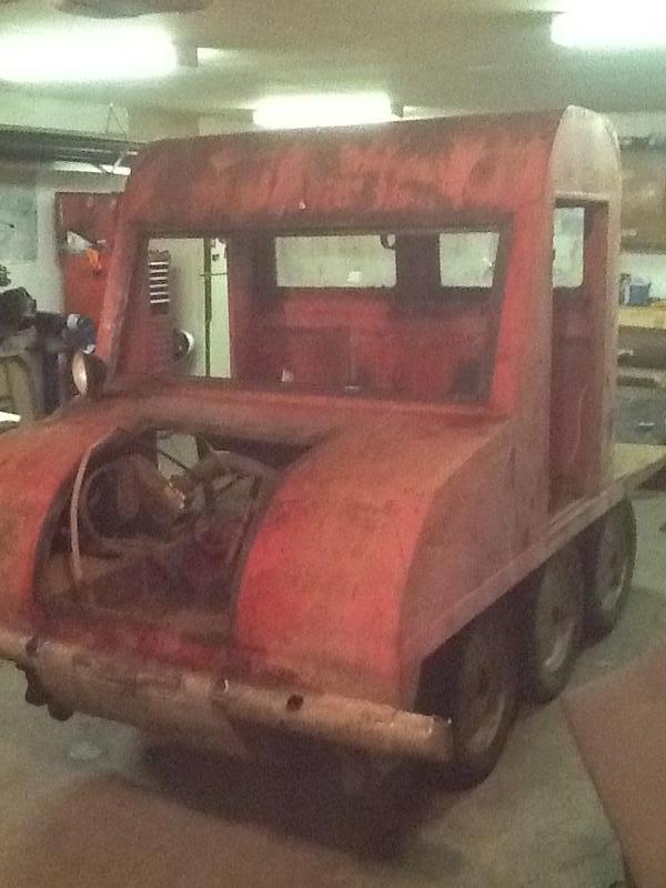

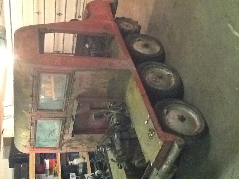

I woke up with a stiff neck and thought this might prevent a few other folks from suffering it as well.:yum: Enjoy and stare straight ahead!:flowers:

It's just a port for a PTO. Lower left side.
As for engines, measure carefully. There's not much extra room in the J5 tub.
I have an all original J5 of the same vintage and a Ford 300/6 attached to the same 4 speed transmission as yours in a different machine. I'll measure them this afternoon.
