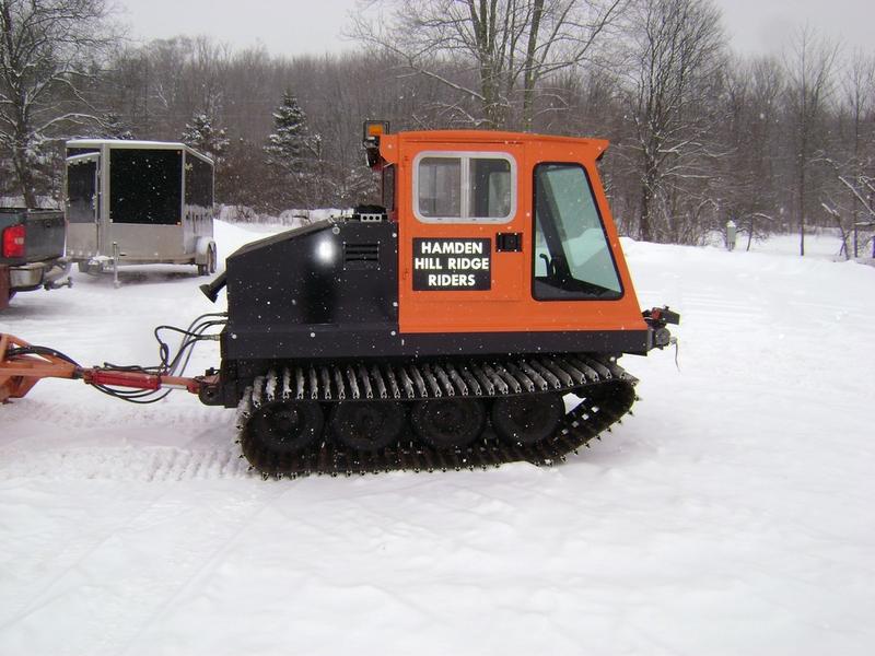

Boggie,
A nice conversion on the cab, very innovatiove! Your work?
Where does one sit to steer it? Yes, I know in the cab but normally the pilot sits in the middle, I see only a left and right seat?
Ho my god ! So nice... I'm full motivation.
Like you said radar, missing small seat.
I see, look Radar, may be the 2 arms close of the left door ( hydraulic )
Boggie,
Well, This is not my work, just pictures from a club....... they did a nice job though. the steering is through the ram steer on the drag so you steer with one lever between the seats. if you did not have the drag there is another way you could put on any brake steer and steer with a electronic joystick we have done many conversions
Here is a nice Bombi upgrade with a 2.3 Bronco engine and tranny cab redone

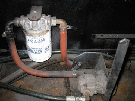

Well I finally stopped looking for a new clutch and found a guy that rebuilds them, he charged me $300 and rebuilt the clutch, pressure plate and a new bearing I had it back in less than 24hrs. My next question is there is a small hydraulic pump belt driven off the drive shaft, does anyone know what this is for?
That pumps the differential fluid through a filter and back to a cooler behind the radiator. I assume the system serves the purpose of keeping the fluid clean and cool, and I have never had any problems with it. Beware though - Bombis can collect water in the differential and the pump will distribute it in the filter and cooler. When I bought my Bombi it hadn't been run in several years - the bottom of the filter was rusted out (the air leak will prevent the pump from working) and the cooler had split open from water freezing in it. My local radiator shop patched the cooler up and with a new filter (Napa 1551MP) it runs fine.
The pump simply circulates the diff oil to the cooler on the rad to keep the diff cool.
