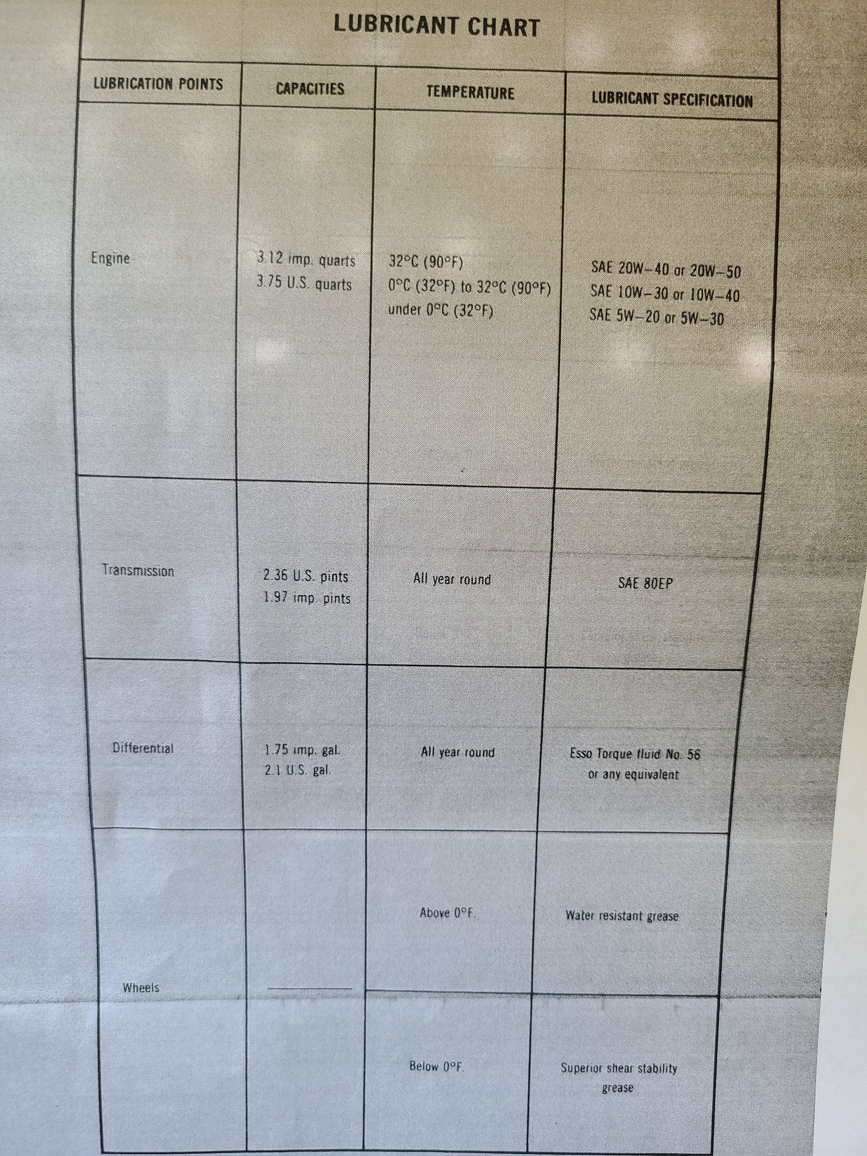

Answers in pic , for Diff u can go with SAE 50 if warmer climates

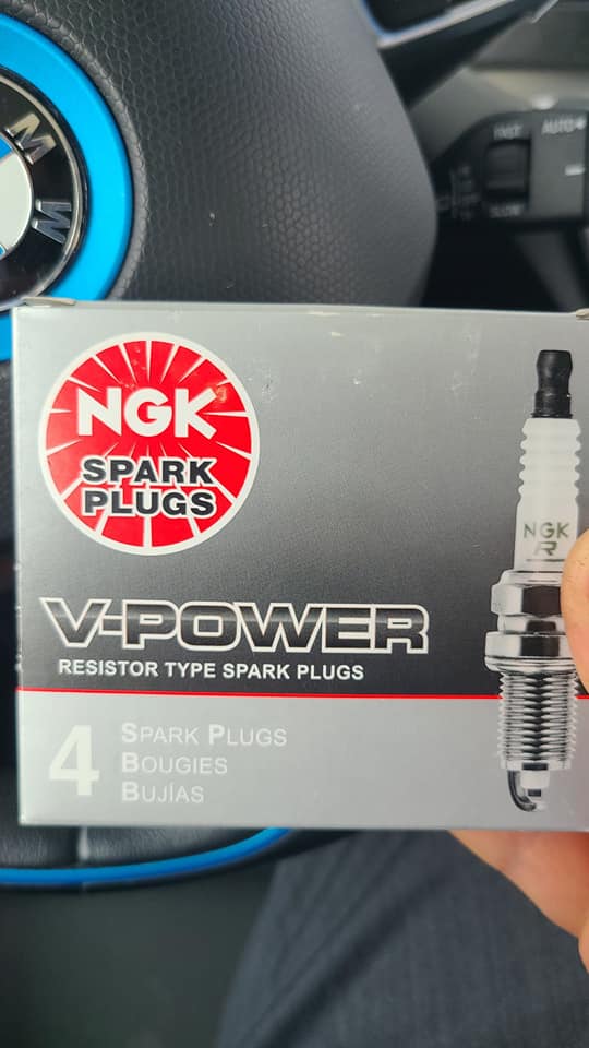

Spark plug replacement
