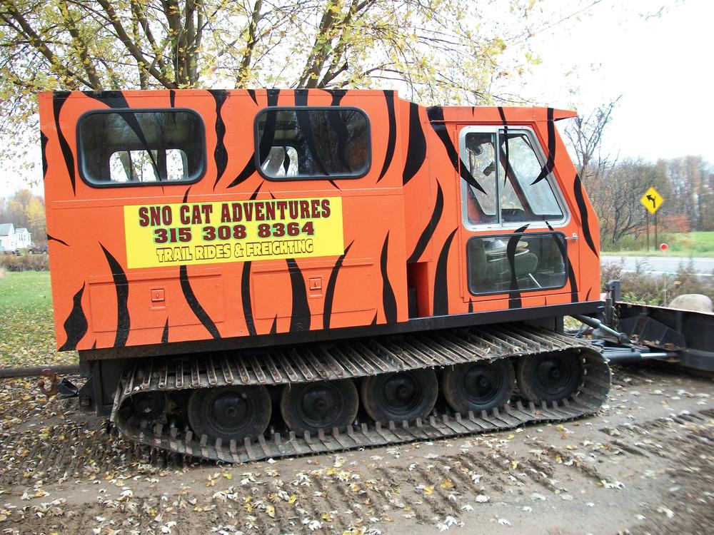

where would you b using it----he in the north east we will never get enough snow to stop it-----had one----the only thing about mine was that when I put the box on mine the extra weight made it steer hard---the 6 cyl. ford would pull it along just fine
