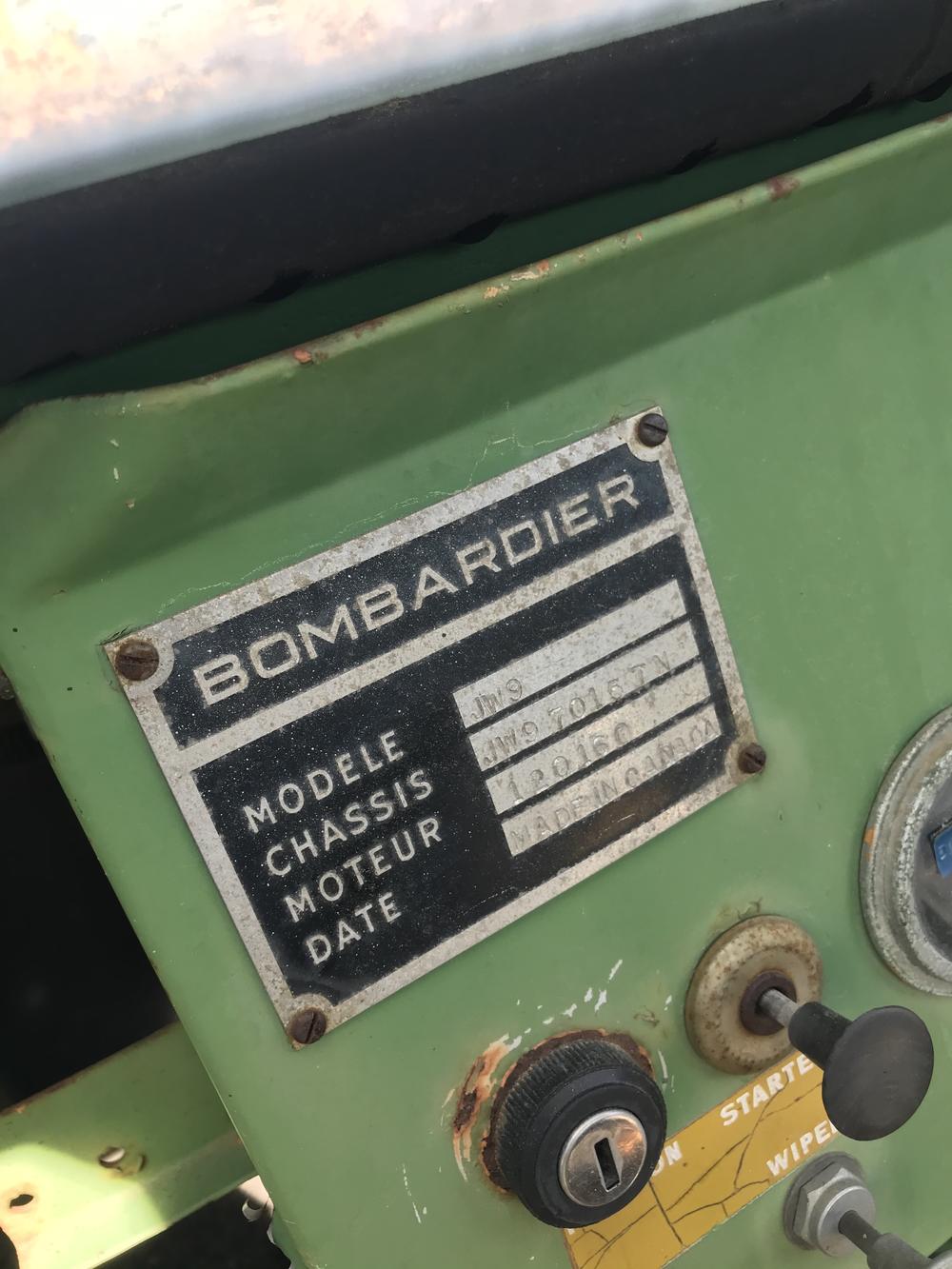

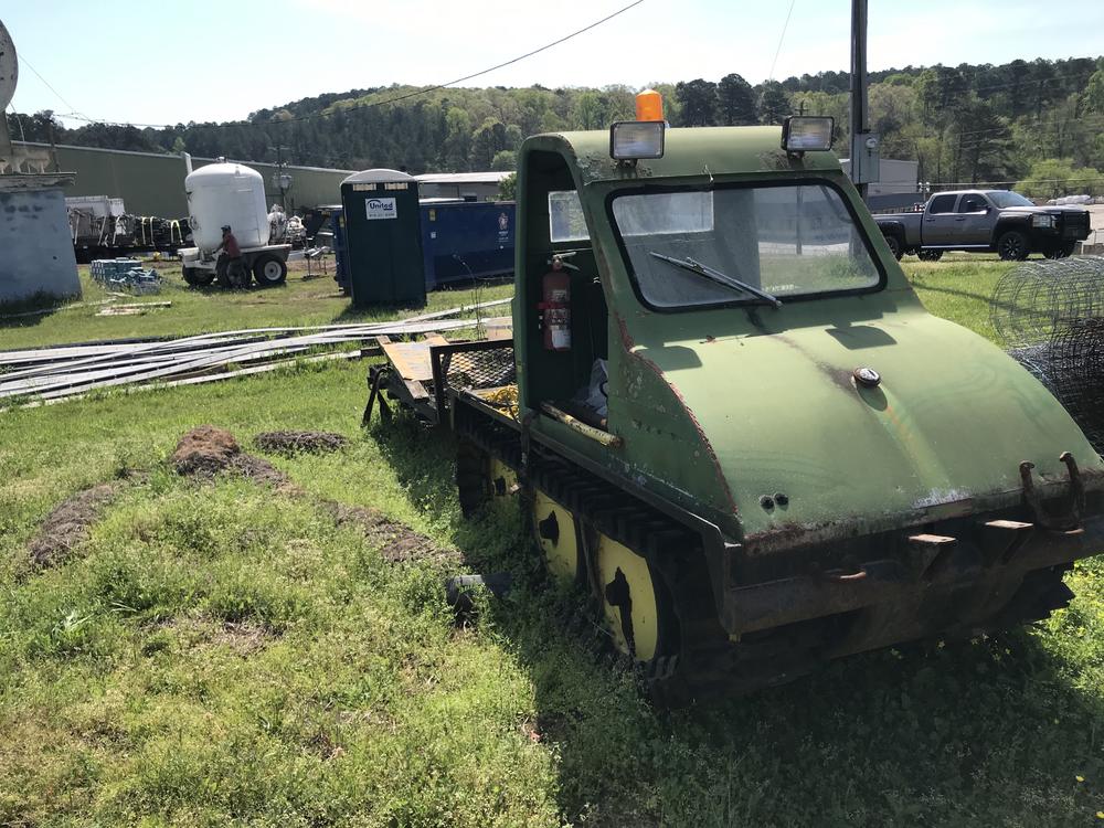

im looking a bomardier jw9 i cant find any info about it i think its very similar to a j5 or sw48 if know anything about it i think it has a flat head 6 cylinder heres a few

Just when you think you might have these bombardiers kind of figured out a tag like this pops up.
Either way, nice machine ,I'd be all over that like a fat kid on a Smartie.
J5 Bombardier
ok ill have to check im going to pick it up this week it been sitting for 5/6 years any thing other the grees and oil and fuel i should check before geting it going? btw im a litter new to the bombardiers
so i got it towed it home now im working on getting it going i did measure it its 48 inch wide and 10 ft long over all im trying to figure out what year it is?

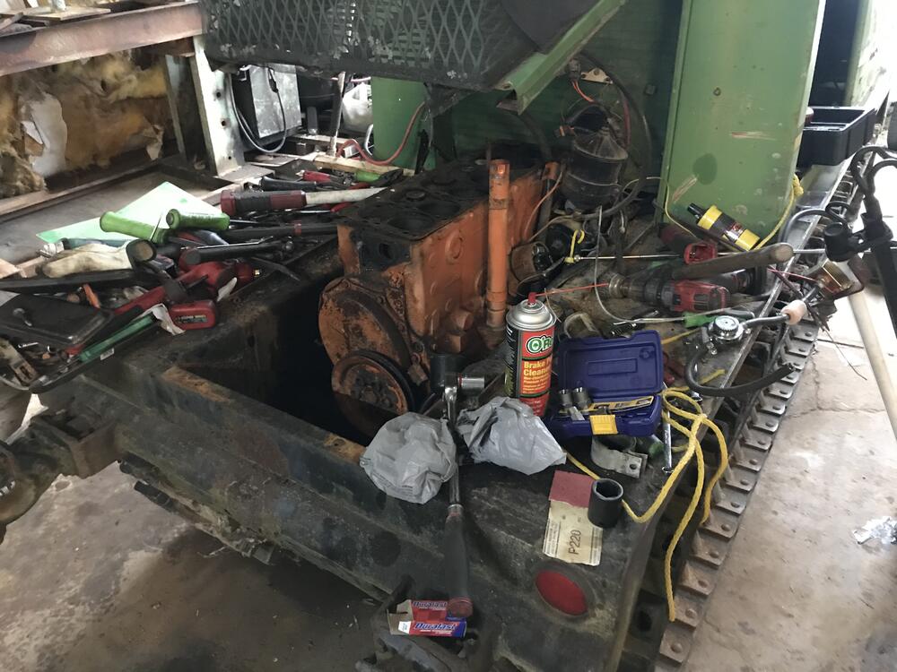

So I went ahead and pulled the intake and head and found the stuck valves freed them but the keep get stuck so I think I’ll bill them and clean them up here’s some pic of it and do anybody know where to find a exhaust manifold I had one crack on me ?

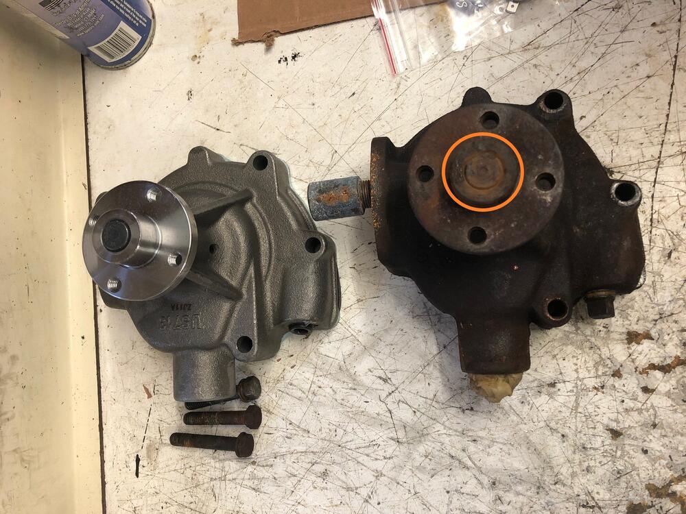

hey do any one know were to find a water pump for one if a Chrysler 251 ind motor i got a gates brand 42554 and its close but the pully don't fit it touchs the hosing ill post some pics when i get some
42554 from Napa is the number for the last water pump I put on a 251. Now whether I had to grind the housing for pully clearance, don't recall, but it's still on there. I know it had a modern type seal compared to the old one, which I couldn't find a kit for.
Late to the game here, but my 265 had the same exact issue. The new pumps have a slightly different casting. Sitting side by side they were identical other than a microscopic difference at the top water bypass cast area (where the pulley was making contact). But as I was trying to figure out why, I found a shim on the old water pumps flange (so gunked up originally you couldn't see it). It was probably 1/16" thick, but still wasn't enough. I put the old one back on the motor and then could clearly see the WP pulley was offset to the crank pulley a full 1/4" and had been that way for?????? The perfect shim was on the old pump. We heated the flange to drive it off of the shaft then machined the center out of it (in orange). Drilled the 4 threaded holes and used that for the new shim. Pulleys up perfect now.

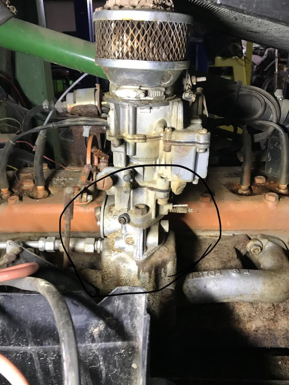

ok so it runs new wires and fuel pump the biggest problem was with what i thin is some kind of cold wether choke or somthing its under the carb in between the carb and manifold theres a throttle body that wasn't letting enough air in any body know what it is and do ?
The side plate screws with the wire seal are a sometimes tough to get out of the aluminum housing, inside another set of plates with an adjustment/ spring set to close if over speeding. I just cleaned up a 2 barrel version on a 318 works fine , on my 2 flatheads I don't use them, I never go over 2500 rpm ,they do not liked to be over revved, but that's just my opinion.
