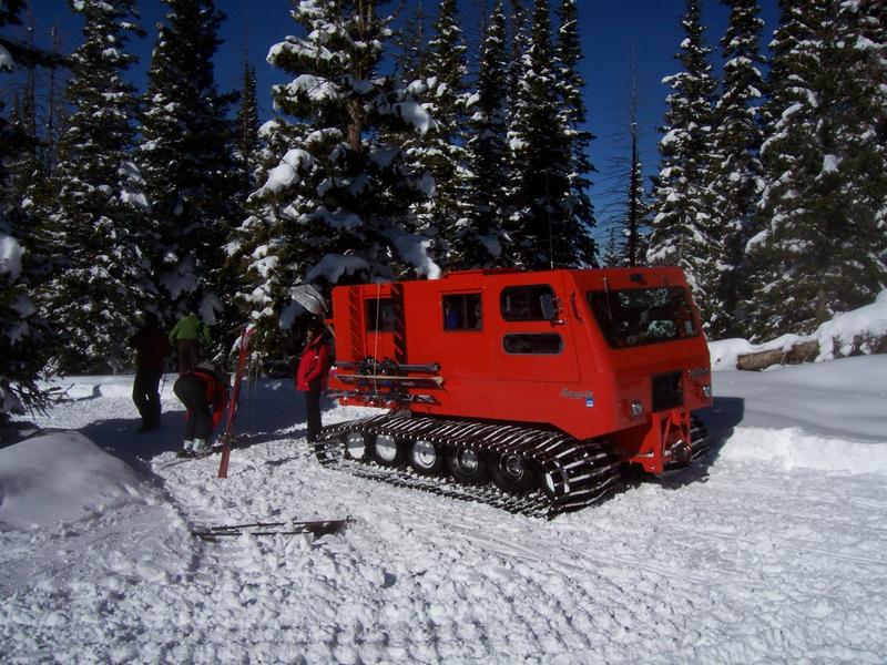

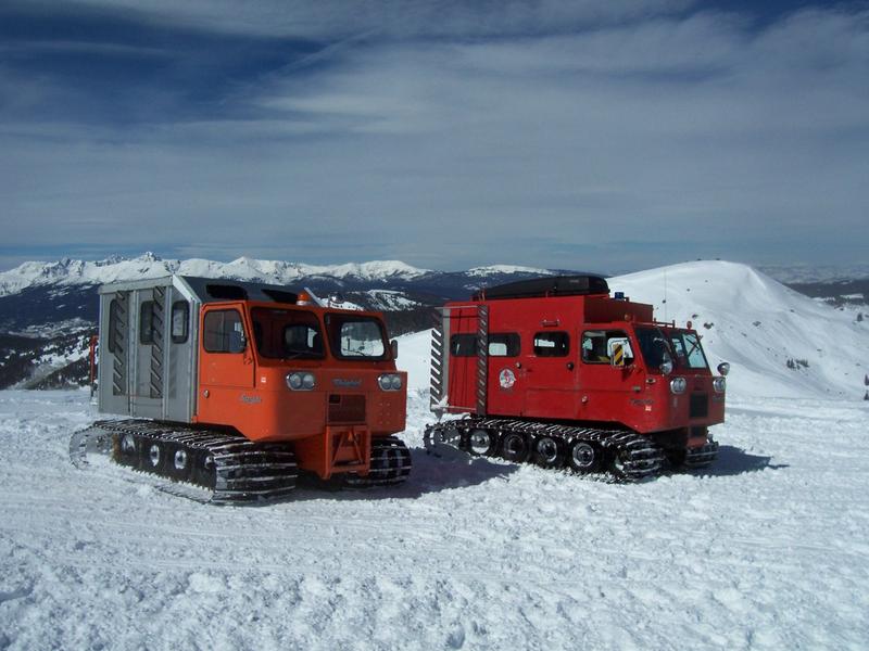

Check out A-Model Spryte they work for us. Only about 10K instead of 35K for a C or 1500. Not as tough but you don't need it for what you want to do.

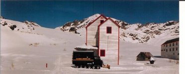

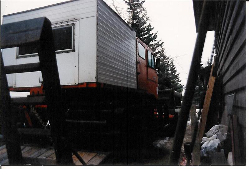

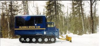

This is a 1977 Spryte I bought for $11,000 in 1995. Then I transformed it into a deluxe tour cat in 1998 and "tried" to make a go of a snowcat business in Hatcher Pass/Independence Mine from 1999-2001 and finally had Bill Gunthrie sell it in about 2004.
