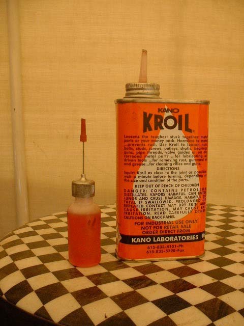

1. KROIL penetrating oil.

Mine came in an aerosol spray can. And if I took a photo of mine it would not be laying on its side :moon:
