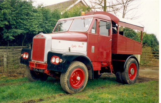

Could try either of these..............The Scammell has a generator on the back, so could be handy for lighting etc.

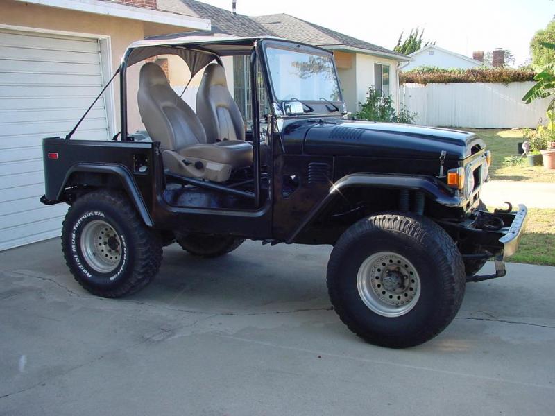

Modified 1979 Toyota FJ40 landcruiser.
I redid all of the electronics to meet EMP shielded specifications.
Tweeker
Nice, but here's the problem. No protection and it needs to run on diesel. But tell me, what did you do to "rebuild the electronics" to meet EMP shielded specifications?
All wiring has been replaced with shielded cable.
All through the firewall connections are Mil spec connectors.
the emissions computor is housed in an EMP metal enclosure.
the 12 volt ground is now a dedicated line omitting the through frame return.
the engine run electrical is dedicated and redundant.
300 amp mean green alternator elliminates the need for a voltage regulator.
All fuses have been replaced with aircraft grade circuit breakers..
I tested this in the field of an antenna transmitter sweeping from 50MHz to 9.6GHZ and monitored the received RF on the 12 volt buss, battery disconnected of course.
The received RF energy was only .4 microwatts.
Tweeker
P.S. this one runs on the 2F inline 6 gas and carburated.
