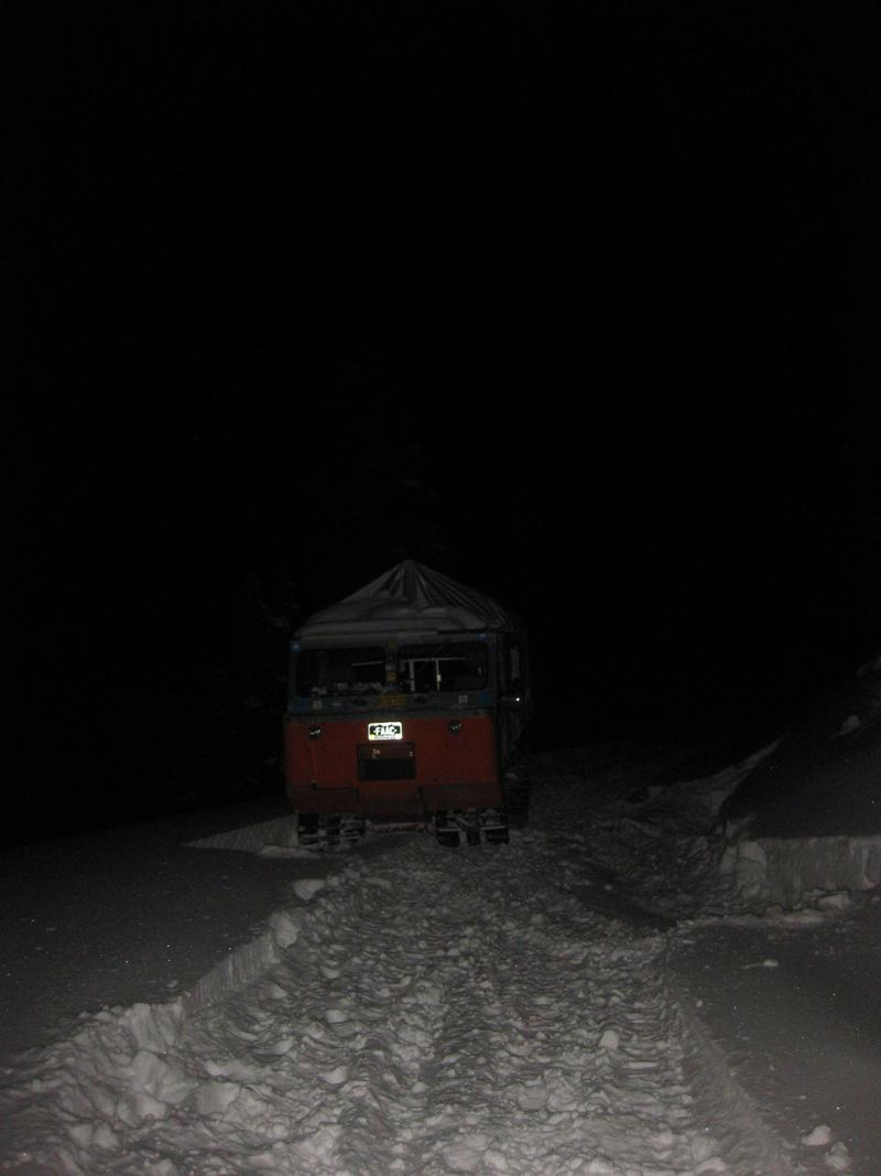

Next day I'm driving back up the road and ran out of gas...I was always worried about doing that and sure enough I did it.....skied up to the cabin for lunch, then back down to BALTO to get the empty gas can...down to town and got some pals to give me a snowmobile ride w/ gas can up the road......filled the tank and although I could get BALTO started it would not run...idle for 5 min and die...I knew I had plugged the fuel lines and was "stuck".....skied up to the cabin (2 hours 1000' vertical but at least I had a track)....spent the nite and as always enjoyed the nite alone knowing it was 20 F. up at 11,800' and 0 F. down in the valley....next day after a quick ski run I was back at BALTO scratching my head...decided to pull the fuel line at the fuel filter inlet and blow back to the tank...did this, re-connected the line and there you have it...BALTO never quits
