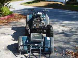

Here's a picture of mine before I stretched the frame back out, welded it up and put the front fenders back on it. I still need to wash it and clean it up. I went field hopping with it yesterday and came back with a ton of milkweeds all over it.

I can't enlarge the pics so I can't tell the extent of the twisting/bending.
In the front-end picture (I can't tell):
Does it have a bad toe-out condition?
Are the handlebars bent? I believe I have a new handlebar but it's for a LT-F250. I believe they're very similar (but I think mine has a cross-bar). I can take pics/measurements if you need a new one.
The original owner drove out into the street and hit a car with it. In the first picture there is a vertical frame bar coming down behind the front tire. The main frame pipe was broken clean where this bar meets the lower frame. In the second picture the right front tire is back about 8-10 inches due to a severe inward buckling of the frame. I strapped the buggy to a 3 foot tree and using straps and my pickup pulled the frame back out. I must have done a pretty good job as it drives straight and does not pull. I was also able to put the front end plastics back on without forcing any holes to line up. I can tell the frame is still tweeked a bit as the front fenders do not meet the gas tank plastic the way it should. I did have to do a lot of welding to fix the cracks everywhere after pulling the frame out. The bars have a minor tweek to them. I think they will be fine once I swap out the frame. It does drive down the road straight at 35mph without any pulling.
