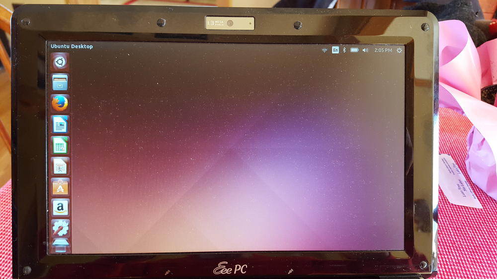

I got it!! Turns out these little netbooks can be picky. At least the bios can. They really like it when you create a bootable disc image from a utility called Universal Net Boot Installer. Once I created a bootable disc image of Ubuntu with that, there was a second option in bios. It said the the first boot device was the HDD. Second, Kingston USB, my flash drive. Tada. It never said that before!! Changed it to USB #1 and I was off and running.
The process was easy and straightforward. I partitioned the 160GB HD in two, with Windows on one and Ubuntu on the other. The first install did not go according to Hoyle as the Grub boot installer did not install so after a reboot, Windows would start with no option for Ubuntu even though it showed the HD was partitioned. So, one more try and sure enough Grub installed this time and I now have the option on startup which OS I want. Perfect.

Yeah, this is working good. Only thing so far is bluetooth will not connect to anything, but I will look into that further later on. I rarely use bluetooth for anything outside of the car.
The Atom processor is no speed demon, but adequate for basic use.
