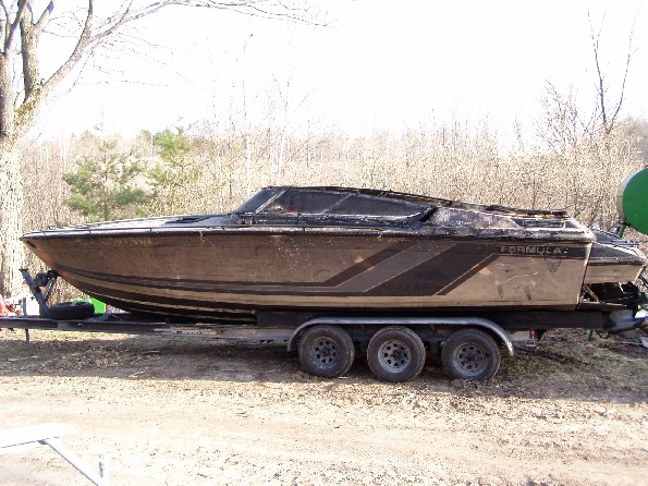

Here's my latest project boat -

Rick; Nice Formula. What's the story on it? What ya got for power. That could be a nice looking boat.:thumb::tiphat::beer::beer:
Someone on another (boating) site mentioned he knew someone that had it for sale. It had been in winter storage in a building that burnt. The boat didn't burn but it sure didn't do the gelcoat any good.
Twin 454's with the Edlebrock performer kit with Bravo 1 drives and K-planes. S'posed to be ~425 h.p. each and push the boat to ~75mph. I've had them hooked up to the muffs and had both running. Drivetrain appears good. :coolshade
Sure was a long ride from central Michigan to Richmond Virginia and back (in one weekend) to pick it up with only my dog for company.:pat:
I started grinding into the cracks on the gelcoat, and am now thinking about just sealing it with CARC (Chemical and Acid Resistant) paint as all cracks are above the water line. Otherwise I'm going to need alot of gelcoat. Maybe I'll go talk to someone at the Four Winns factory down the street...

Are you thinking of restoring the Formula or are you using the engines in your other boat? I bet you got some looks towing the formula in that condition.

The term "Rubber necking" comes to mind...
I was asked "Was that boat in a fire or something..." so many times I finally had to resort to "No, why do you ask?" :pat:
Original intent was to repower the 36' with the engines and part out the rest...unfortunately, I never was too bright!
