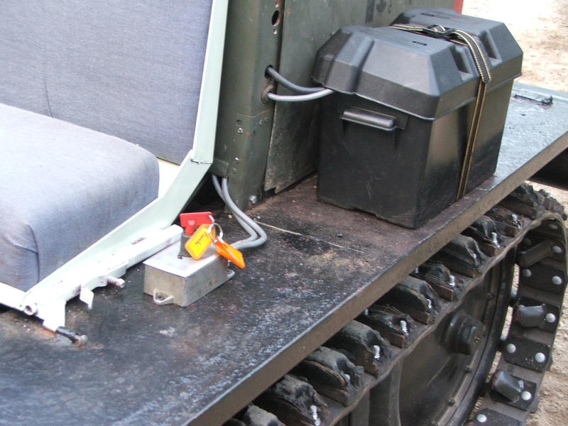

I use a kill switch that I bought at Princess Auto. Just like most military tracked vehicles, the kill switch is a straight cut-off on the positive side of the battery!
Here's what it looks like. I haven't had a problem since.
Thank's Guy's I have installed a switch for boats that basically is like the kill switch and it works. I am still going to put on the diode That Duckscarfer suggested . jim
