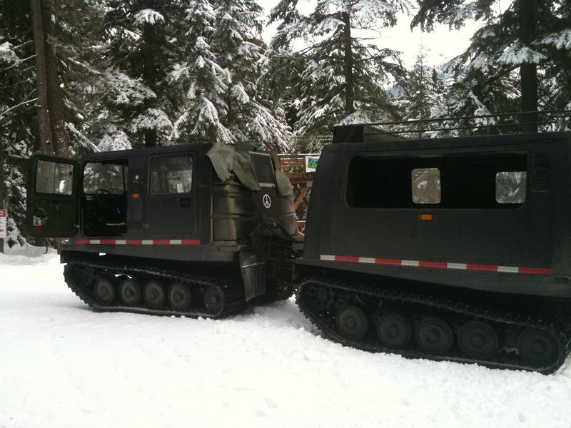

Well, It's here now and 218 Bryan got it right. We bought this BV 206 to transport people approx 1km up a snowmobile trail to some zip lines. It will move 12-15 people 1 km 4 times a day.
I've been playing with it for 3-4 days now and I think it will work for our purpose. I wasn't impressed today when the temp warmed up and we had slushy conditions but I guess only time will tell...
This machine has new paint, head rebuilt, new tracks all around, all new road wheels, etc etc etc.. It also came with about 25 used road wheels with bearings in decent shape.

I like the peace sign on the back, sort of makes it look like an old Hippie mobile!
