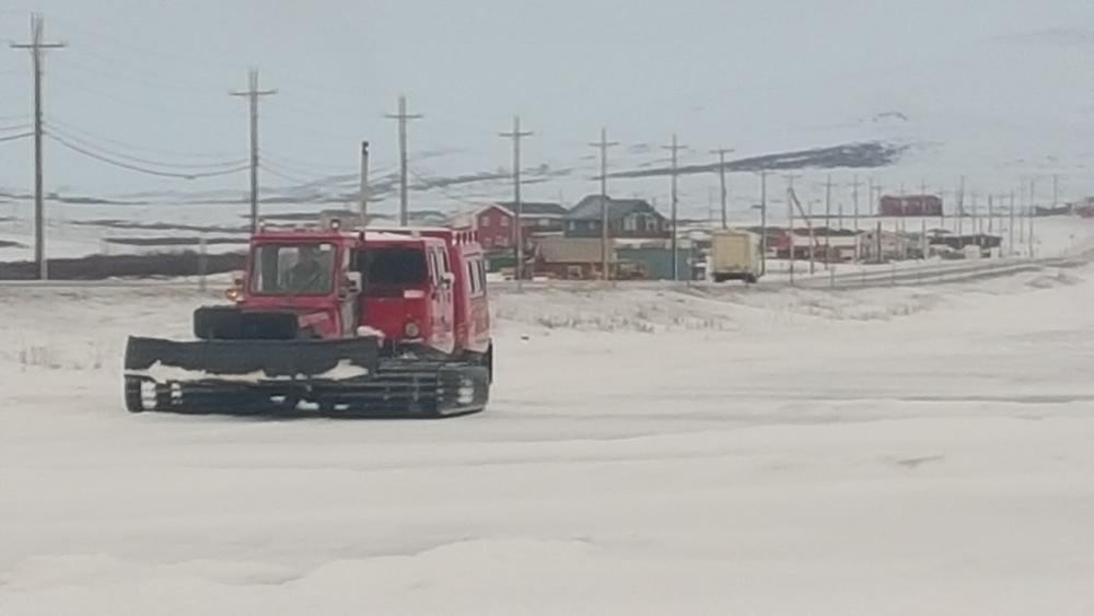

the local krusty oops I mean bv206 coming to town for a transmission replacement

I would have thought that Nome, Ak would be one of the last places on earth for vandals.... What a shame to spray paint on such a nice machine and especially a Kristi relative! :wow: I am suprised that it was not stored in a secure building. Is it a diesel model?
your right not as bad here as some of the villages you get out in surrounding villages you don't want to leave tempered glass unttended. the construction company's band plywood over the glass so its there the next spring. supposedly 420 is some dope smoking code must have come about as dope legalization came about here in ak.
If it was a real krusty it would be towed in on a trailer :whistling:

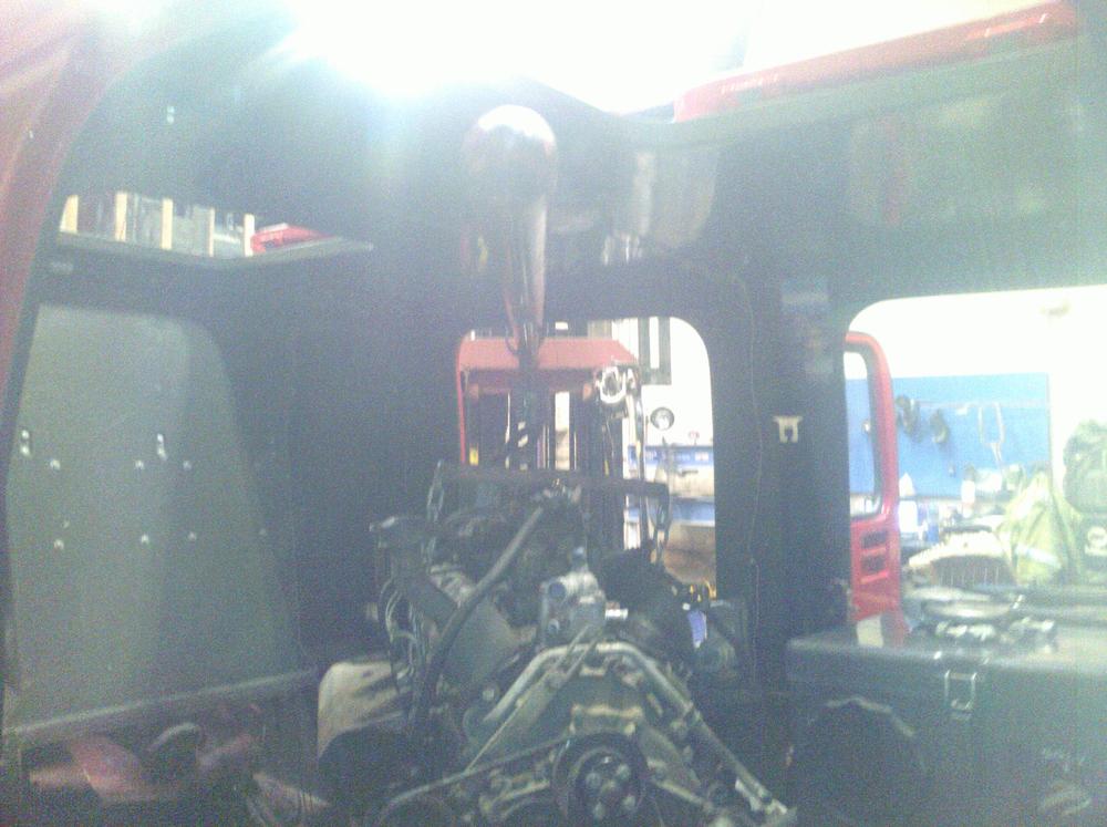

mike I will text you some pics I built that one off the pattern for the military bars as I get some more time I will post sone pics of pulling they power pack with out the military apparatus so guys like you can get an idea of how to service the power train components.
the lighting sucks but you look close you can see where I used a 3 inch pipe attached to fork lift forks and a come along to lift the power pack and pull it out through the drivers side rear door

Nice work don.
I am thinking that timing is spot on.
Governor seems right on the spot as well.
