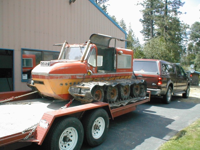

This is what I use . The 20' is rated for 12000 pounds and hauls really nice . www.starlitetrailers.com .I picked it up new in Okalhoma City for $2500 but that was about 5 years ago . The over deck 16' cost me $500 used and handles a 4000 pound load . It also carries the load nice .
I would look for a 12000 rated trailer if I was limited to just one .
JMO
I went over scale and my br100 was just over 3400 lbs this is without the blade,so add the weight of blade and you should still be under 4000 lbs
