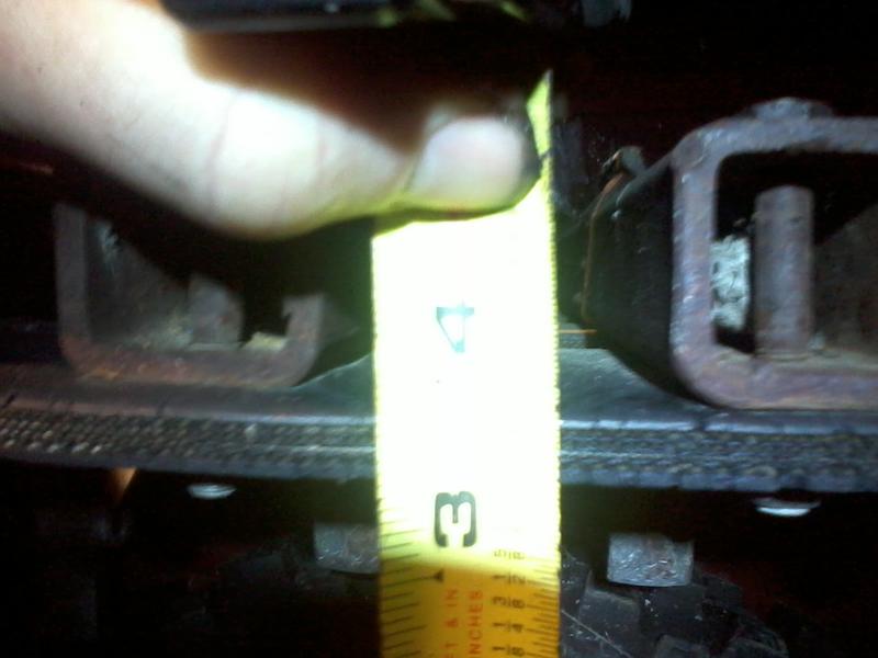

Does anyone know what the original track belt for a 1970's st4 was? What I have on mine is 5 ply. 3/8 inch total thickness. Top and bottom is 1/16th inch with 4 cord belts separated by really thin rubber. Looked for similar in catalogs for conveyor belting but didn't find anything. I figure that I'm going to go 3 ply conveyor, but am curious about the current stuff.
Thanks

Found out this IS the original belting. The grousers are not, but the belt is.
It is more flexible than the 3 ply my friends imp has.

I agree that 5 ply seems excessive. I just thought it was interesting that the 5 ply was OEM at some point. I have been looking for conveyor belting that had the same top and bottom layer thickness. Since I wasn't having a lot of luck, I thought to see if the OEM style was still out there. No luck on that either. I did find some WHITE belting so if I wanted my ST to look like the Matchbox...
I figure I'm going to look at 330 lb 3 ply and go with that. But thought it was a different take on the usual "new belting" thread.
