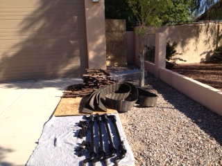

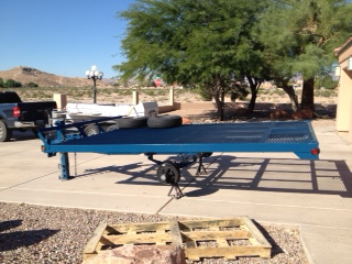

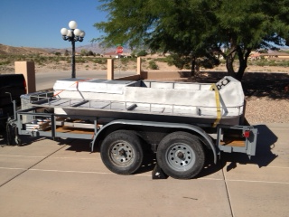

Well guys I need somemore help. I have stripped the body and frame down to bare metal. What is the best way to paint it, powder coat or Airplane prime and paint ? Im attaching a couple photos of las 2 weeks of work.
The tracks are completally dimassembled and the trailer needs wheels and tires but beside that its finished.

if you are doing alumnum use a good aircraft quality etching primer than shoot it with a base clear poly uratathane paint it will look good for years i used cheep enamal on my snow trac and its starting to look a little rough now after about 3 years next time it will be base clear
