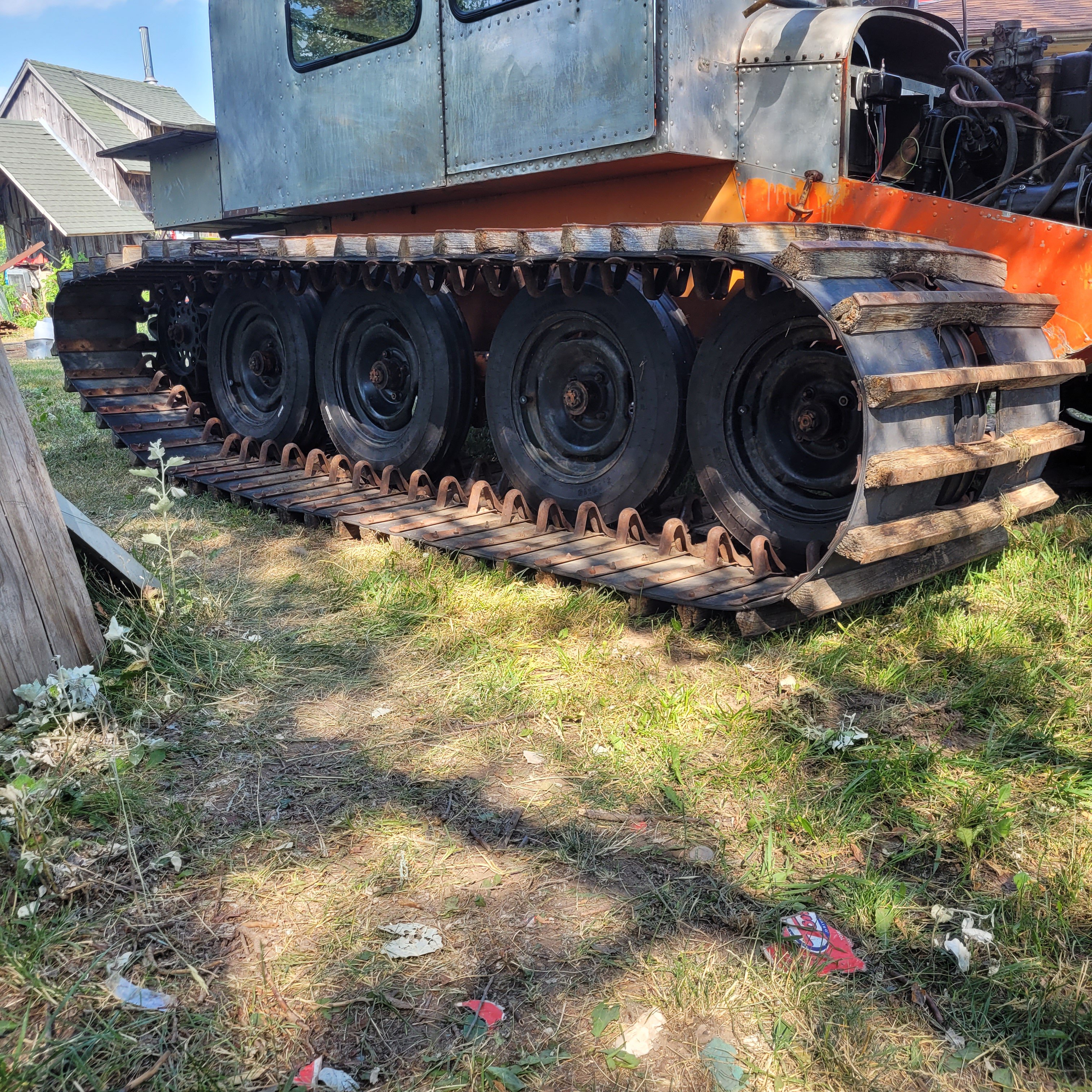

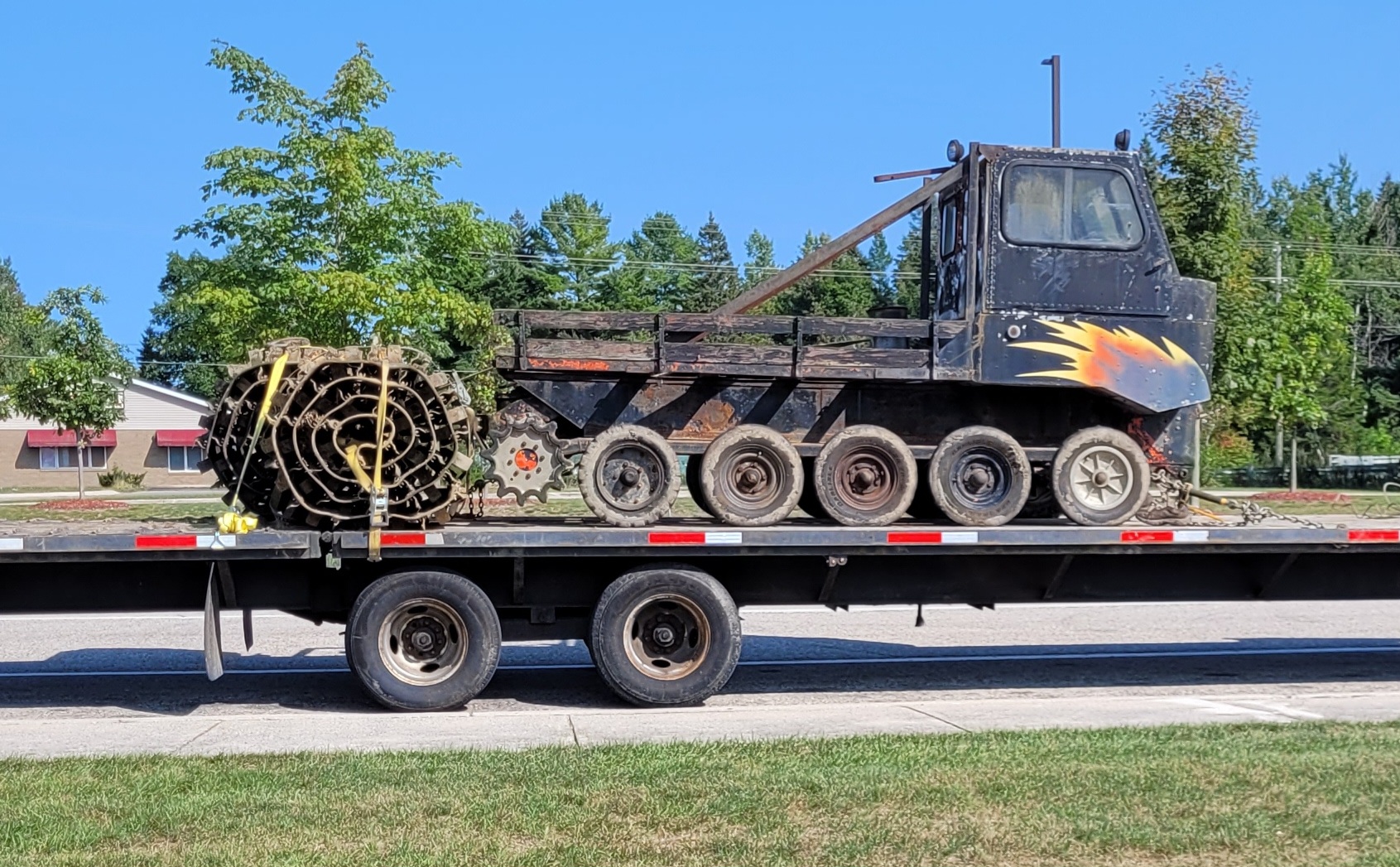

Kind of a rebuild thread. Remanufactured implies restoring. Ill be rebuilding what i can. Restoring what i need to.
Thanks to a moose for the honor to foster parent this rig.
4vl for comparison
Nice. Kind of like this guy. I call it the frandee-wanna-be
Not much info on 4vs on the interwebs.

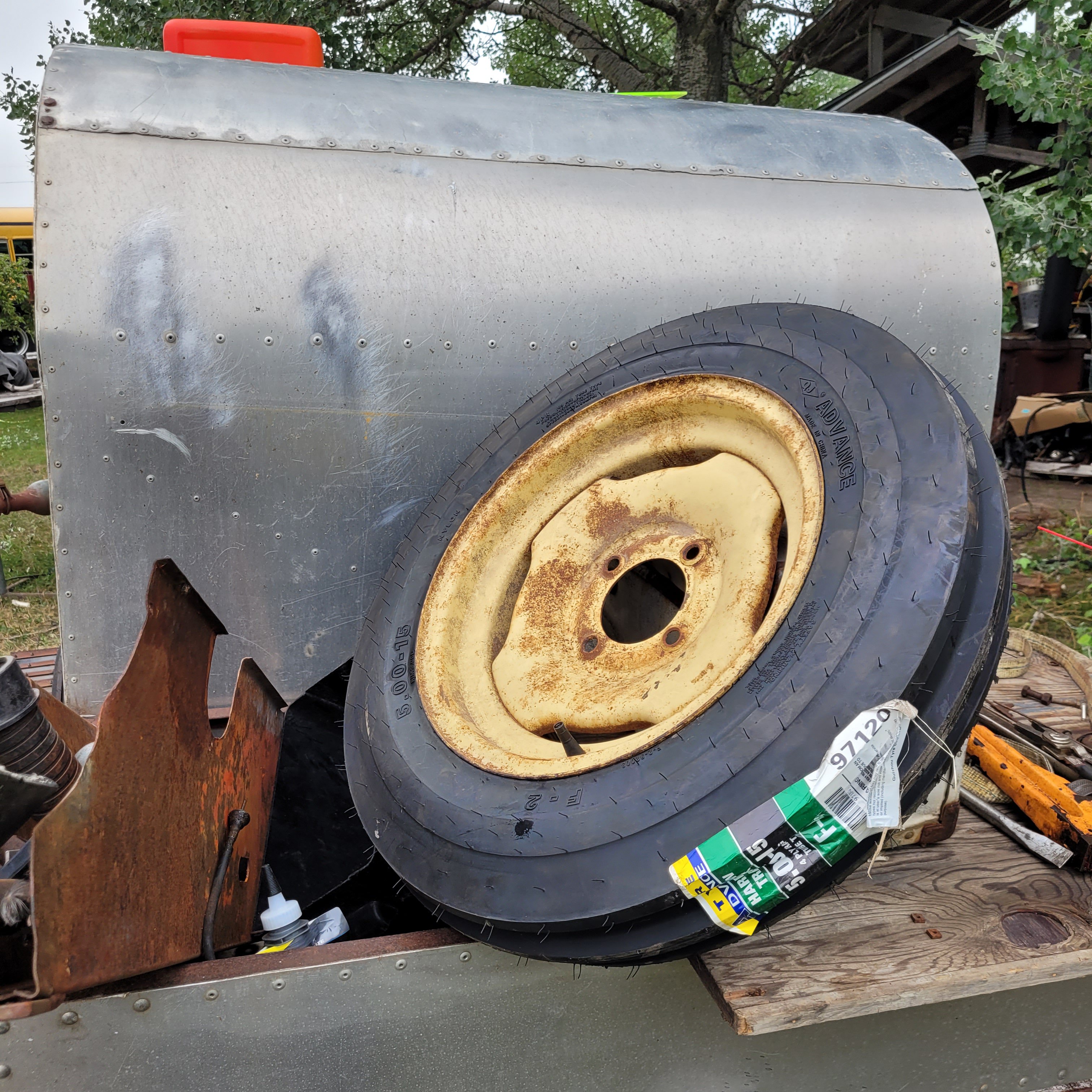

I was able to locate a implement wheel for the project. 4 hole, correct build, correct offset!
Mounted up the spare. Im running tps sensors and something did not feel right when i did this one.
The video is 2 days after i mounted it. Im roaming around the yard and hear psssssss...
I am like what the hell air hose let go, where!, why!
Only to find the SPARE!
WELL today will be the third time i mount, dismount and remount this cursid wheel.

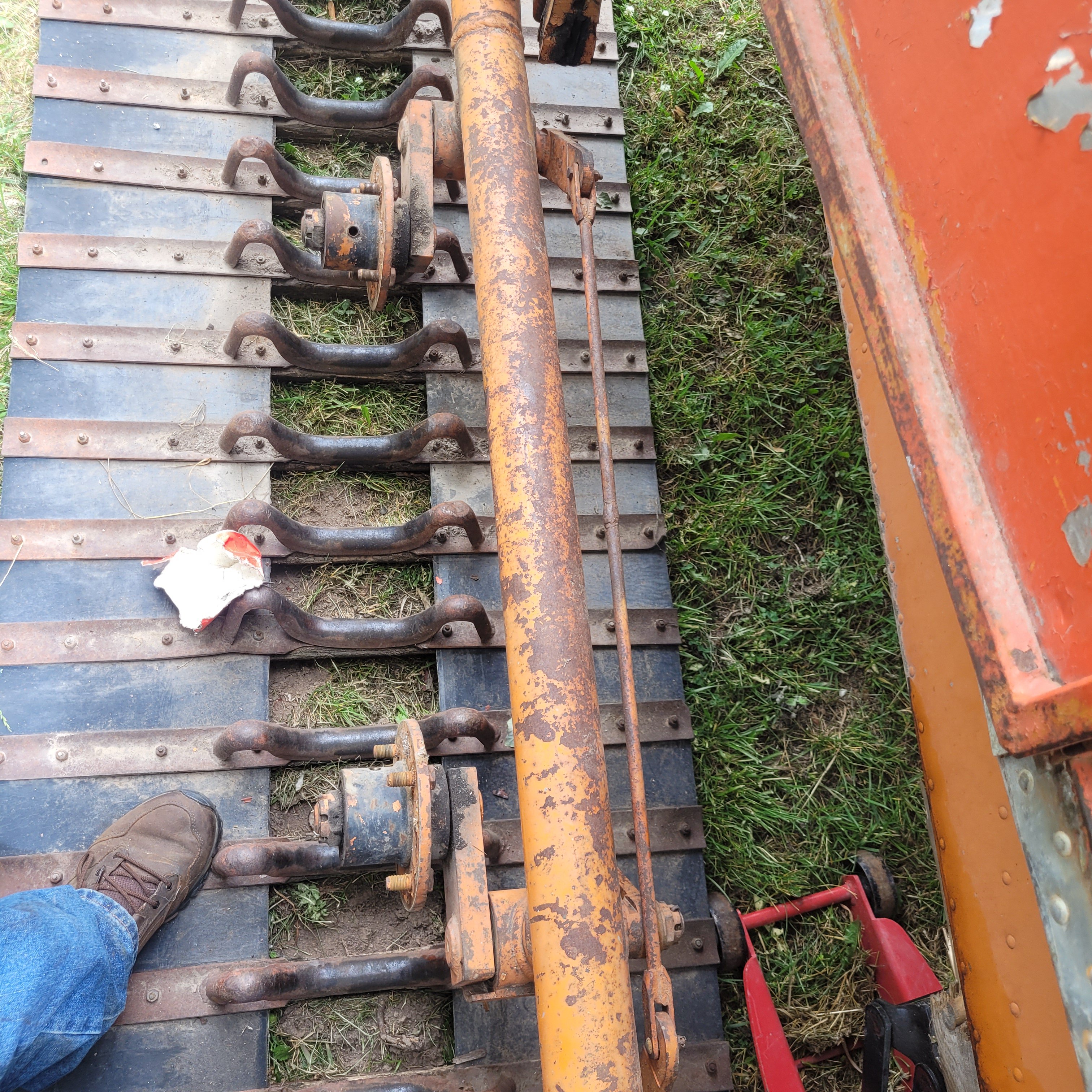

Stalled on rebuild, got the throttle and choke cables routed. The gas tank consumes to area directly in the lap of the operator. I needed to fit some tubes past the tank to allow the cables to slide.
Needed to drag this home for parts.

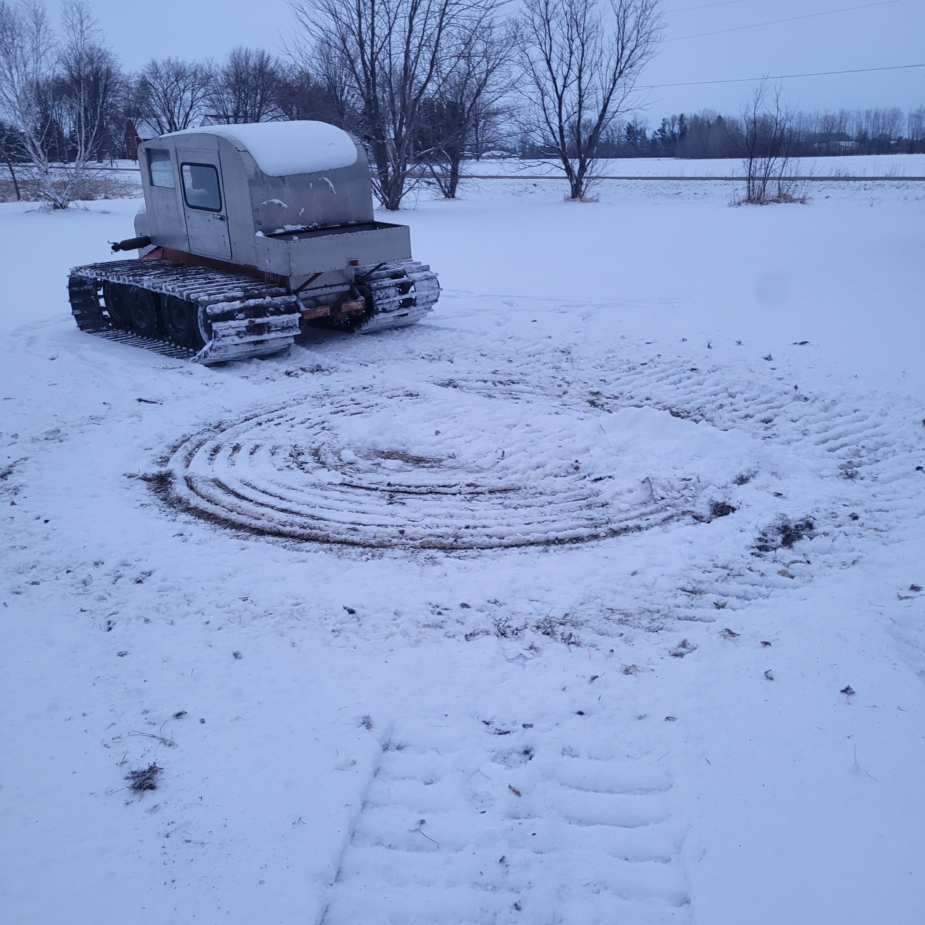

We had a crap winter and i forgot i shot some content of this cat. Right after the co jamboree a fellow ff member and i had a discussion about adjusting the clutch packs. (Rear diff) and when we had a little snow a month ago i took to the yard for some testing

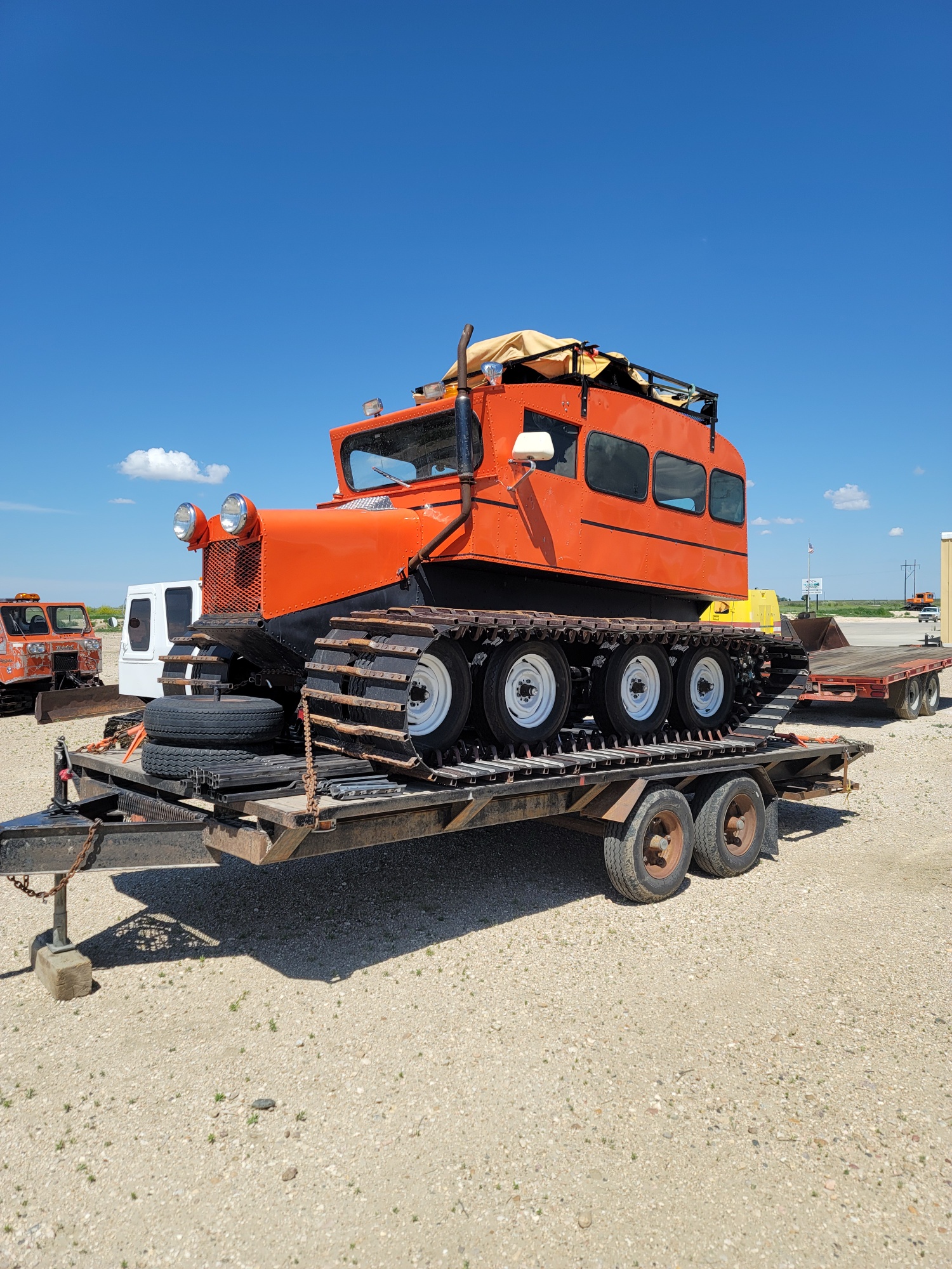

The 4VL pictured is mine and lives in Sinclair, WY. Tracked Outdoors was helping me with finding some parts, they are a great team to work with.
Mine is S/N GSA-25 and I know S/N GSA-30 was in Casper, though I am not sure where it is now as it was for sale. I would love to see some of the differences between versions. If there are any within a few hundred miles of me, I might be willing to take a short road trip to look at them.
