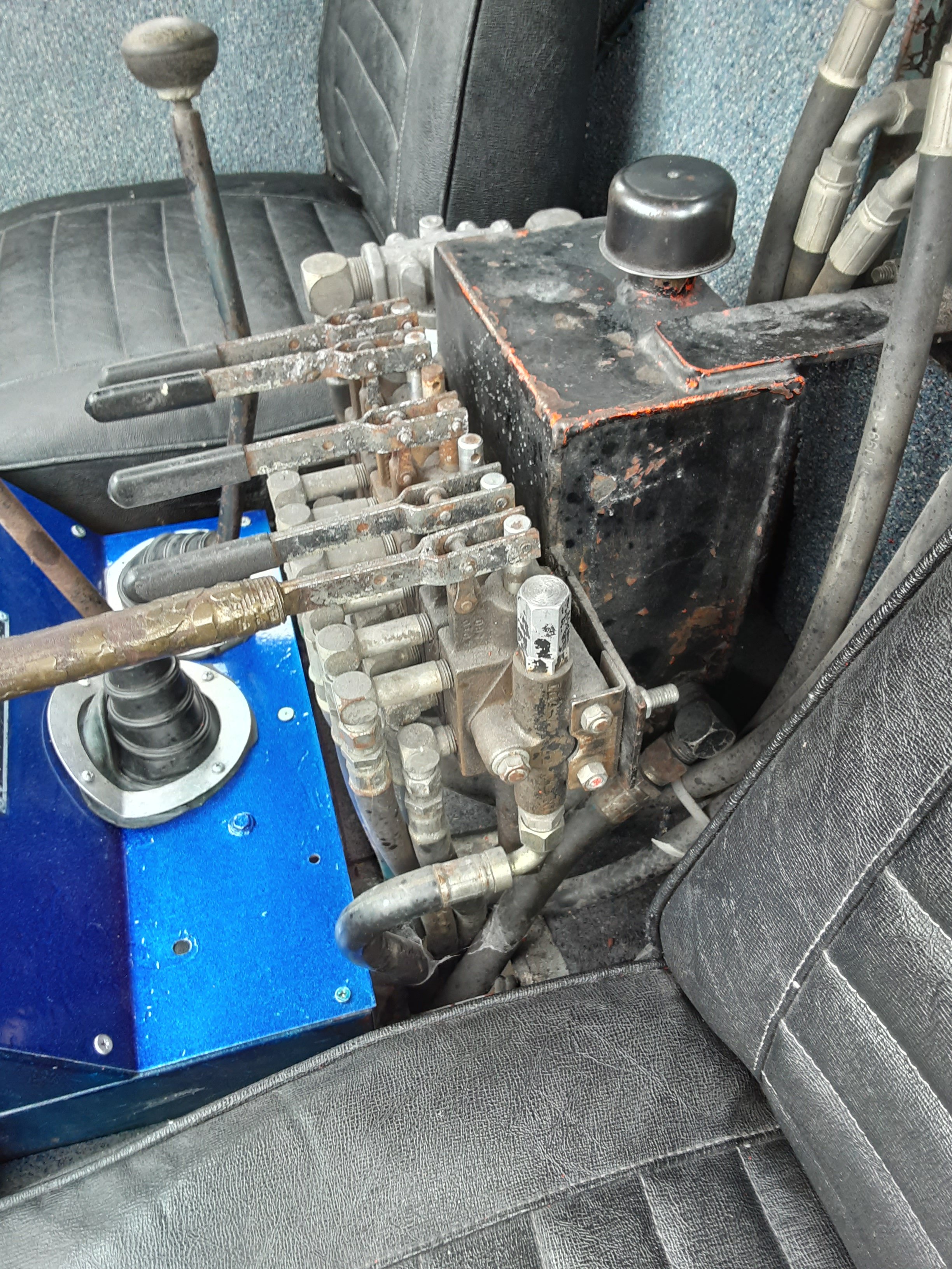

So, mine has a stand-alone blade and hydraulic system which actuates blade elevation and/or side angle. Works fine, zero leaks. Also has 6 ports on the back of the cab for God only knows what contraptions were towed and powered by it.
My system includes a 2 gallon tank and requisite controls between the seats. Just today I replaced the filter and checked the fluid level...about a third of the way up the tank. From what I've Googled for hydraulic systems in general, one should size the tank to be 3x the gpm rating of the pump with 10-20% additional head space to allow for expansion when warm. That said, the math would lead me to believe that my pump is rated at around 1 gpm, give or take, which seems low for what I presume is a standard automotive power steering pump which put out between 1.5-3.0 gpm. Assuming that's what's installed on my engine.
Also, my fluid appears to be standard red colored ATF...which should work fine and currently is.
I want to throw a few quarts of ATF in to bring the tank level up to maybe 3/4, to aid in cooling and less chance of cavitation.....but I don't know diddly friggin' squat on this topic. So if any of you have a similar system and depth of knowlege please chime in. Then, pray for snow as I'll be dragging her up to my cabin late October.

Thanks for the input. Somewhere I had heard that add-on systems like this commonly used standard power steering pumps and that ATF was used vs. power steering fluid being better at low temperatures (early Ford cars used ATF type F in their power steering pumps). I did some Googling about hydraulic fluid colors awhile back and found that they're clear or amber mostly, but yes some red formulations exist. Thus I'm making a lot of assumptions since Google is never wrong...heh.
Your info on tank size makes a lot better sense and would seem to match what most standard power steering pumps output..anywhere from 1.3-3.5 gpm depending on make/model/rpm. That better matches my tank size.
Dumping the system, ugh. I have maybe 2" clearance to the drain plug at the bottom of the tank and would need to devise some means of catching/redirecting the fluid. Either that or pump out the tank from the top. No idea how to purge the three cylinders and all the lines unless unscrewing all the fittings is the only way (and fear future leaks). And how to prime the system (maybe self-priming after a couple minutes of running). Like I said...I'm ignorant.
Thanks again.

Again, thanks. I didn't realize that Thiokol would make-to-order Imps with hydraulics...always assumed it was a custom add-on at a later date. Yeah, I can see the pump high on the drivers side but can't identify what make it is.
Either way, you've set my mind at ease regarding fluid type (F) that I was planning on using. Current fluid looks clean as a whistle, just replaced the filter with a Napa 1553 to match what was on there. Don't even want to consider purging the system for fear of screwing up ancient connections.

Yes, Do less. let it give you a reason to service it. if it is 40 years old, doesn;t leak and is low and not clowdy. shake the notion out of your head that is telling you to improve something. I suggest webbed lawn chairs and cold malt beverages.
The best advice I've heard in years. If it ain't broke....
Outside of maybe adding a quart or two just "for good measure" and to make me feel warm and fuzzy, I don't at all want to mess with this unless necessary. Cans of worms comes to mind.
Just yesterday noticed a couple drops of fluid at two of the rear connections (scrupulously clean prior to painting last month); who knows, those may have been leaking for years and years. Put a wrench to them and will fire up today and see if rectified. After which I'll grab a malt beverage and fuggetaboutit.
