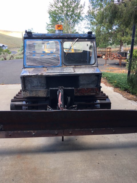

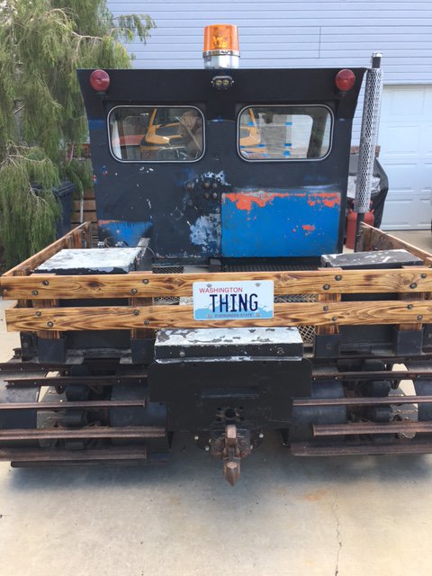

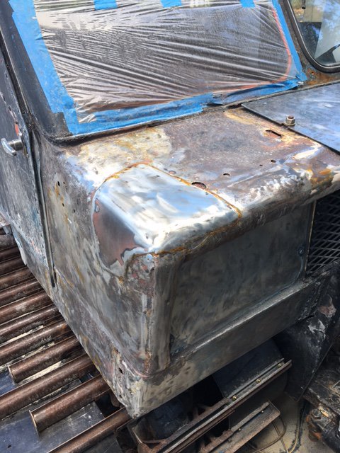

At some point in her life, I'm told a tree fell on her...or somebody got carried away and smacked into one. Broken passenger window and significant damage to the front right cowl that was marginally fixed with sheet metal and tons of bondo (also note the headlights have been deleted). I have stripped all the paint from the steel to get down to rust, and am sanding down the first of 3 paint layers on the aluminum cab and doors for painting sometime here soon. After some new bondo and new windshield (that will show up in a couple days) gonna use epoxy primer and urethane single stage paint through a LVLP spray gun outside in the driveway. May go with orange, may just go back to the blue that was the second layer over the factory orange in order to approximate the interior color.
What I have done so far:
New track rubber and nuts/bolts, fixed the differential, adjusted engine valves and auto choke and set timing at 6°btdc, installed electronic ignition, changed all fluids, new oil pressure gauge and sender, traced all unmarked switches and fixed (this thing had multiple 70's halogen lights scattered everywhere and few worked...all gone now with new LED lights front and back), new wood side rails, repainted exhaust stack and shield, some interior painting and rust repair, removed and painted gas tank.
What's left to do: new tach, paint, pop inspection plate on the differential and properly adjust the brake shoes (live and learn). By rights I should replace the slider window tracks but probably won't.
Drive sprockes have life left in them, wheel bearings seem OK, tires seem ok so will defer spending another couple grand on those until the time comes. This is not meant to be a garage queen...she was rode hard and put up wet... just want it to hold together and be dependable. Over 100 hours of work into it, but my labor is free. Should be worth 3x what I paid when I'm done...but not selling!!!

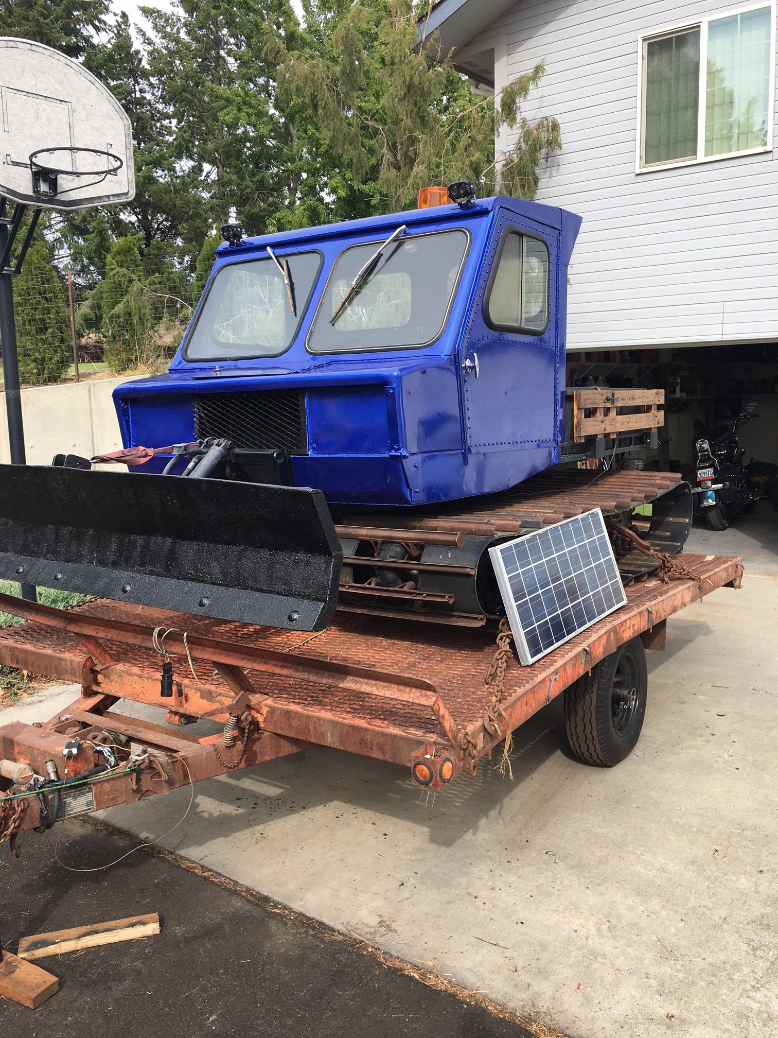

All loaded up and ready to haul to the cabin. So cool to finally be to this point after tons of work, and hoping that the Farmers Almanac prediction for a good white winter holds true.
Original Thiokol single axle trailer rated for 3500 pounds cargo, the Imp shows shipping weight as 2800. I guess that was Thiokol's budget version for Imps only, would be nice and safer if dual axle but whatever, it made it across Snoqualmie Pass last summer and can surely make the 50 miles to my cabin but I will take it slow and easy for the last off-road few miles where things get dicey.
If you've never experienced the ball sack tightening joy of crawling up a steep angled self-loading platform trailer, in super low granny gear waiting for the thing to drop down level before you run out of room...stuffing in the clutch and cranking back on both steering brake levers at the last moment to prevent catastrophic overshoot......well then, you haven't lived. Backing off is a whole lot less nerve racking.
oh yes, live more in 5 minutes with __________, than in a lifetime..... without ___________. some one on here back in the day, said the shipping weight is with out tracks.
After hoisting the tracks around during the rebuild, looking at the shipping weight of the new rubber and estimated weight of the grousers and nuts/bolts, I figured each complete track weighed around 225 pounds...so call it 450 for the pair on top of the 2800 pound stated shipping weight (sans tracks) if that is indeed true. Still within the max load rating for the trailer, barely. Just gotta be mellow with it.
