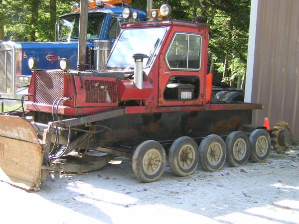

Photo #1 is what he started with?
And if I understand it correctly photo #2 is what he ended up with!

Nice job. I'd like to hear about what it took to accomplish that. There are lots of those 2100s around for "projects"...
Vance
Vance-
That's not a 2100. I believe it's a 3700AC.
Alliis Chalmers turbo straight six diesel and all hydrostatic drive.
Way more desirable than a 2100, if you ask me
And there's a fair number of these around too.
aksnocat said:
Vance-
There I go talking about things I don't know anything about... at least it was a groomer...
Thanks for clarifying it.
V
Aksnocat is correct....this is a 3700ac chassis, but the ski area I got it from installed a 6 cyl john deere 466 intercooled turbo engine from a loader....plenty of hp and runs like a top! I cant wait to get it hooked to the drag, I'm installing the aux. hydraulics to the rear now.

I had saved a van for a 2100 chassis about 7 years ago while i was restoring my 2100 b but to many parts got "borrowed " off it and it never happened.
The 2100 and the 3700 had a jump seat next to the driver and it was not meant for two full grown adults... these cats seem less desireable and cheaper on the market because you cant carry passengers. :beer:
The van holds 6 adults a dog and a cooler nicely!:coolshade
also I have plans to mount one of those back up cameras, like r-v's to see behind you ......so we can watch the drag on the monitor up front...:winterrul
So what is the van based on? How did you build it?
Details man!!! We need details. . . if you take bribes we could FAX you some beer and cash if that would get your story out. Build pictures too!!!
Really a great job. :thumb: How much did you cut the tracks down to make it manageable for width? The wider cats are cheaper since they are not legal width to trailer and do not fit in gates and other tight areas. Do you know your snow cats weight and do you trailer the cat? Looks great...:applause:

The van idea inspired from the need to carry passengers and upon measuring ,fit like it was made for it. The chassis is a 3700 (this is what it is based on) with a john deere engine/hydro drive. . .
The width is 10 feet. unsure on the weight.... Occasionally if I have to trailer them I put them on my low-bed and I have a blanket permit to haul construction equipment up to 10 feet in width in three states, (over 12' requires escorts)
I'll post some more pics in the photo gallery ....I cant seem to post them here....probly me..
