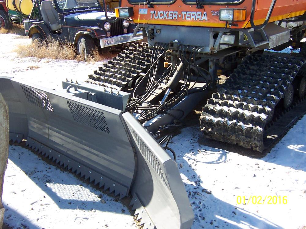

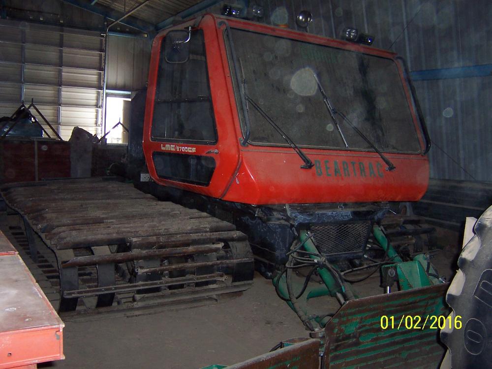

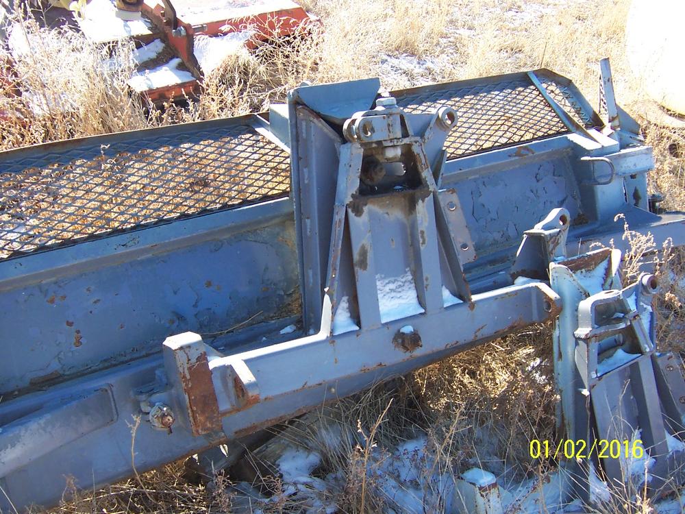

Both of the Tuckers I have owned had the blade attached to the 5th wheel and turned with the front axle. All the blades I have, have a 4 link or a 3 link set up. Here are some pics of how the blade in mounted on the Tucker and a couple of the LMC. There are also some pics of a Tucker quick disconnect, loosen 2 bolts and the blade comes off if you don't want to carry it.
