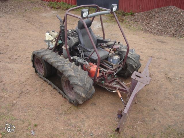

Here in Sweden there are several homemade snowcats with tractor tires as tracks. They seem to be a lot smaller than what you are going to to but I assume the tracks will look about the same.

Those are some very cool looking machine there. Wish I had one of them right now. Mine is definately going to be bigger than any of these. How many hp do these units have? what steering? etc....
I've seen many different engine chioces. The most common seem to be a common car engine like volvo b20 (approx. 90 hp). The gearbox and axels (shortened) is also standard (old 70's) volvo parts. The steering works usually by breaking one track and letting the differential distribute the power to the other side.
Ahh I see. Two master cylinders have been used then to get each side independant from the other. I was thinking of using this system but I couldn't just find another master cylinder around these parts and I just don't have the money to purchase one. This machine I am building will cost me in the neighborhood of $500-750 to complete.
As the machines in the pictures look very low-budget, my guess is that these guys used the mechanical parking breaks for steering.

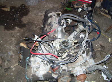

Well here goes the pics thing. I haven't got much done on Critter lately but........ I've got a good start. I was well on my way with this project when I finally decided that the car was not going to do me any justice because of a few different reasons. The frame on the car was rotten in a couple of places. So I stripped the car for the parts and I am building from scratch. I am using a Chev half ton frame, Subaru powertrain and electrical. The steering system comes from an old swather.
Here is the engine & tranny and the clutch system I am using on Critter. I have many more pics so............

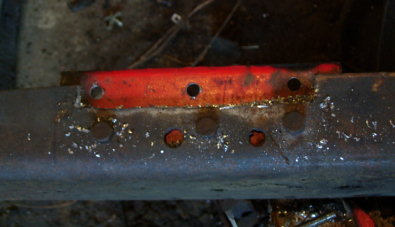

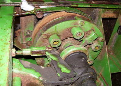

Here's some more pics of the drive wheels and such.
I missed adding the pics. Here they are.

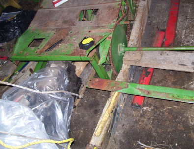

The first one is one of the drive wheels. The implement rubber is coming off and I am using rubber from vehicles.

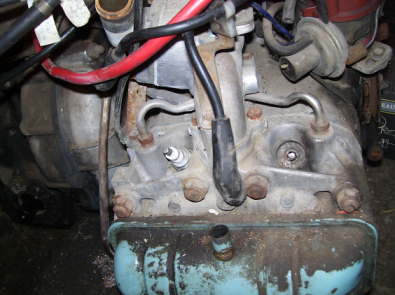

The second pic is of the only thing wrong with the engine. Someone broke off one of the plugs and then proceeded to try to use an easy-out to remove the broken piece. Instead they jammed that in there n broke it off too. The head needs to come off. I need to get a head gasket but has to come out of the states and.... I don't know the exact year of the car the engine came from yet. It is a Subaru DL with front wheel drive tranny. Sticker on underside of the hood says 97 ci which tells me it is a 1.6L H4. Any Subaru dealer I talked to here in Canada can't tell me a thing with the serial number. They say it is too short and that their computer don't go back that far. Can anybody help with that?????
The third pic is a close up of the front pully and clutch band. There is one on each side as well as another different set further back for each side.
You might try putting a oversize steel nut on the "easy out" and then weld up the center . You can then put a socket on it and maybe get it to back out . I have done this many times to shear off bolts that were flush to the surface . You may have to weld it more than once ,but I bet it will work .The heat usually helps break the threads loose too . It if does move ,use little back and forth turns to slowly ease it out . Good Luck .
Big Al,
I wouldn't justify trying to remove the plug your way due to the fact that the easy-out is broken off just fractions of an inch lower than what the plug is. Besides the engine is alluminum and I wouldn't want to melt somethig.
What I am going to do is take the head off. I should be able to drive the easy out out with a punch. Once that is out I will then try to unscrew the plug from the inside. If that doesn't work a friend of mine said he will help me to drill out the plug just a hair bigger (where the easy-out is right now)and then freeze the plug with propane and collapse it and remove.

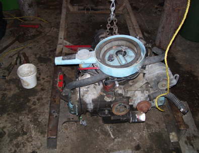

Thought it was time for another update on Critter.

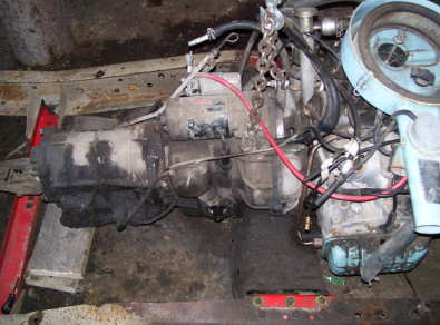

I have been busy lately. Got the frame into the garage and removed the diff and extra uneeded hardware. I then proceeded to mount the engine and transmission and am now working on mounting the clutch setup. Here's a pic or four.
