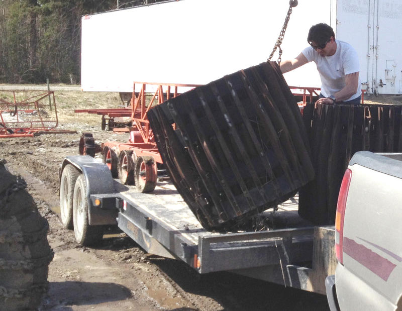

Hello All,

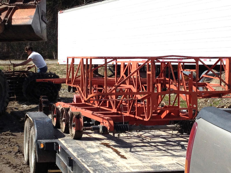

Loaded up the Spryte (whats left of her) and began the process of organizing the parts and where i am going to begin.
This project is going to take some time, but i am excited to begin with a short list:
1: Organize shop around the cat-Open up the Diff/Hope for best/Drain/Inspect
2: Begin blasting and prepping Frame
3: Paint Wheels
4: Rubber Mounted on the wheels
5: Make some welds and adjustments.
6: Adjust Motor Mounts and Play with Linkage
(Need new boots, seals and hydraulics, cylinders/slaves etc.) So sourcing stuff
Looking for ideas on keeping it simple, will probably send the drive sprockets away for some new poly.
Couple early questions...
What thickness of skin should i use (Aluminum) for cab
what are some ideas for replacing slaves and those components...anyone have some suggestions?
I will make a move here pretty soon and show off the painted stuff and hopefully have a Rear Diff that is functioning. Will go from there.
Cheers!

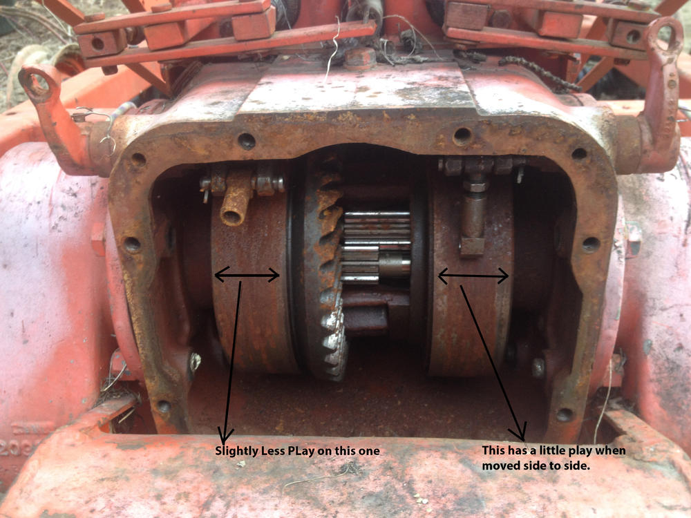

Couple things...
As mentioned, i am looking to gain access to the gear box via the side panel.
see picture arrows...do i need to remove the gear shifter, or is there a trick to releasing the gear box access panel? It just floats around and remains attached even after bolt removal. "Reveal the secrets" !
And of course I am still stuck in gear as mentioned, so far i have removed axles, and dust boots, and gear shit linkage, and now ready to gain access to gear box.
Lastly, a couple more questions...in the other image i made a couple notes to
the brake drum, is there any reason to be concerned if they have a little play in them? In other words is there a bearing issue there?
Thanks,
Andy

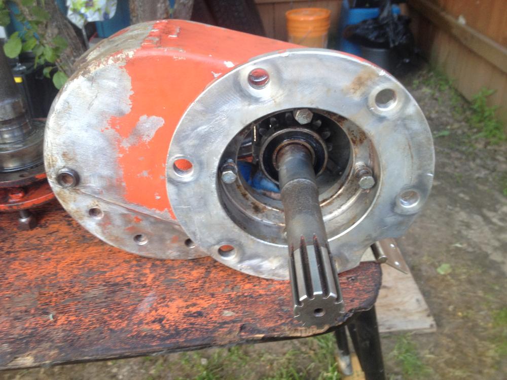

Progress Report on OC4
1: Both Axles have been removed with Drop Boxes from Diff, and with some love they are spinning and seem to be just fine. I have them soaking now and am feel that they should be good to go.
2: Slaves...Removed the cylinders from the top of Diff, and am working on them. Cleaning them up and giving a bath.
3: Removed Planetary from the Diff Box...I happy happy to report all Gears and Planets' functioning, the seals were in excellent condition, unfortunately the bearings were a little rusty but spinning. I am giving that submersed bath for a little while while i prep for paint. But all is well and this diff is functioning!
4: Removed Shifter from gear box. Peaked around inside through holes, cannot get it out of gear...filled with Diesel Letting it soak. Mostly the gears look good inside, although obviously there is some rust and it seems to be locked up, for shifting it out of third. I cannot get that damned access cover off, but hoping a soak will allow this to happen.
The drive line through to diff was turning well both directions with zero friction after i had worked it for a bit before i stripped it down, and now i am preparing for paint and putting it back together. I really need to seal this thing up properly when i am ready. I found a gasket template on here for the gear box, does anyone know of one for the Diff plate?

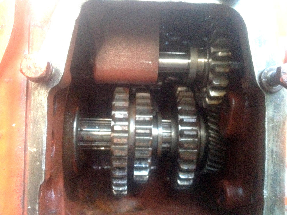

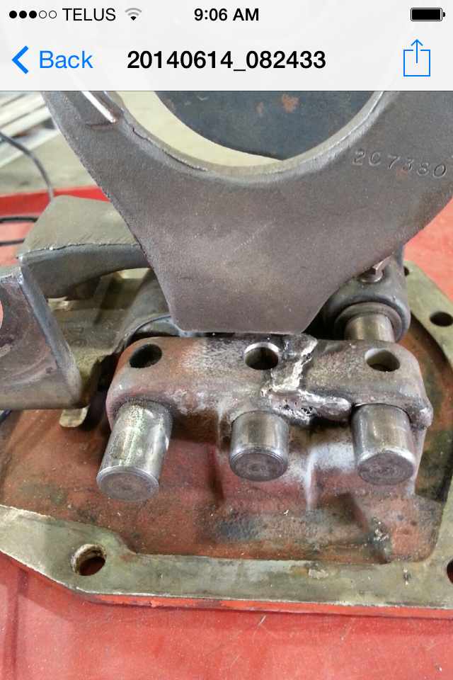

Opened up the Gear Box, after some soaking.
Found the culprit, rather the damage from someone trying to jam it or force gears at some point.
Anyway, as in the image there is a problem, and I have it the problem being welded and fixed.
too bad, as everything else seems to be pretty good. Going to work on the one sticky axle tonight, and begin the cleaning process for painting.

a rock crusher straight cut gear box looks to be some wear in the shift forks too,or is that an illusion from the photo
Ahh, im not totally sure, to be honest im flying a bit blind, I have cleaned it up some since the photo, and things "look" good to me, but im going with pictures of others and not much to go on ....to compare. I like the look of the gears etc, so far, the pics a re a tad rough, but you know, still some rust etc. Those forks seem, so be ok?

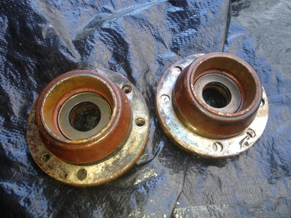

Axles,
found some carnage in the axles...
All bearing issues, seals etc...
According to the manual, here are some cross reference bearing numbers
FIGURE 9-2
80= Outboard Bearing #mrg5210kg
78= inboard Seal #19450 c/r
6= Bearing Inboard #skf63082rs
14= Ball Bearing #fbc 6306pp
21= Ball Bearing (have not removed yet...anyone want to spot me this number?)
64= Ball Bearing #6207ks FAG
Going Order these up and put it all back together again cozy....
Suggestions, etc....
