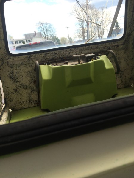

Scored a nice Trackster today! Full cab, roll bars, 137 orig hours. 1500$
Fired up. Little TLC and should go well. After the Tucker should be a piece of cake.

even if it looks rough on the out side it looks pretty nice on the inside I like the Polaris atv engine swap some one featured earlier that was a good idea as the omc motors had cooling issues and rarely held together more than 30 hours
Hey nice job, I think it was well worth that with cab and roll bar. I have the original motor out of mine it was supposed to be good seems to have good compression just didnt have spark and didn't mess with it. I just put the polaris motor in it instead.
the trackster uses a real cool hydrostatic system there are 2 pumps I believe they were sunstrand pumps driven off a ring and pinion spool type set up connected to the engine by a drive shaft and each pump had a direct line to the hydro static motors with a control assembly attached to a t handle. you push forward or pull back to move and twist the handle to go left and right.

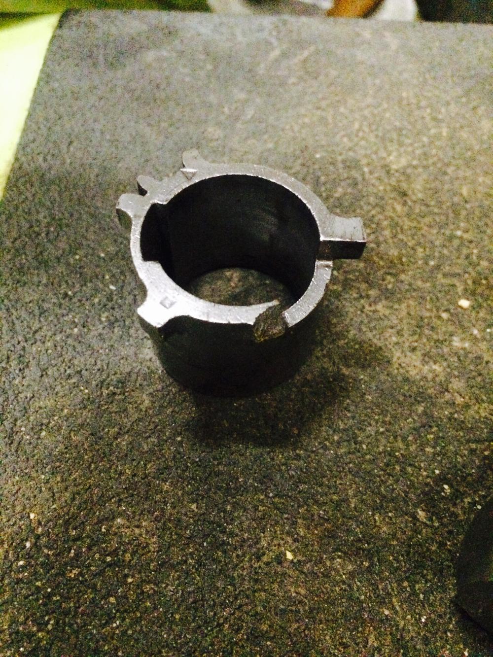

Diving into this project while waiting for more snow. So far got a few belts coming. Need to find flywheel knock off tool, points, coils. Once I can fire it I am sure will need more.
Got the flywheel off to replace points. Found the ignition cam has a broken tab. Real nice and clean/new looking.
The manual says it is a high mortality part but replacement seems unavailable.
Any idea where to find one?
I will look through my stuff, I have three or four onan motors from tracksters I've repowered with Hondas
Damage comes during the installation of the flywheel. To clean, check, replace points you pop the flywheel off. That piece stays on the shaft. When you reinstall it inserts into the flywheel. If you are not careful it becomes dislodged and when you tighten the flywheel snap. The manual refers to this part as the highest mortality part along with the CD box.

I did find one in the parts just let know what you think it worth? Then I will decide whether to hit it with a hammer or send it to you :whistling:
Good news maxtrax had one new one left he just emailed me on bought it 59$ I can't sleep when I can't find parts or have something broken. Urgency to resolve that situation always causes me to outbid myself.
Was going to start at 65$ then at your mercy from there. Hold on to that though could break my new one and be back into negotiations!
