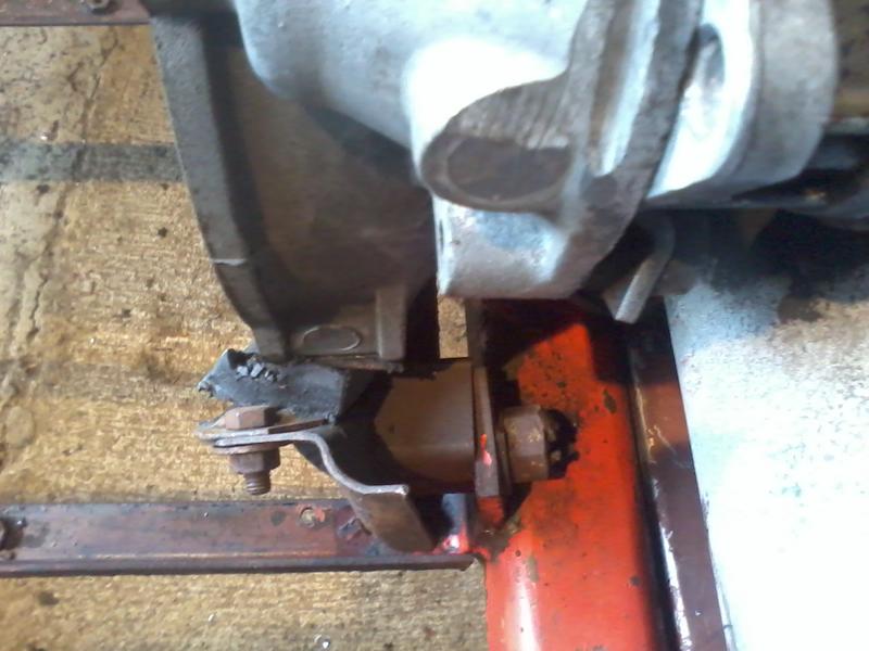

Bell housing mount, I don't think it is supposed to look like this. I thought it was bent metal, but the carrier is straight. I turned a new spacer to match the OEM one last night and will work to find out why the shift. Some one in the past had welded on top of the nuts, but did not weld the bolts. The bolts had been tightened enough that they broke the weld, and or the nut.

this is mine. But I have the orginal style stale air heater for the early snow tracks.
The mount should be the same.
you have a bad motor mount let me look if I have one I will drop it into the box I sand blasted the st-16 b this weekend and painted it it's in the box waiting on my wife to pick it up now. if I have the extra mount I will drop it in too
sorry my trans is too deep in the snow just broke an st -11 trying to free it I believe it is just a bug motor mount try averys air cooled there I believe they are in Portland
New mounts are in stock at my shop. I saw the rubber earlier and ordered them just in case. I just can't figure out the why of the almost 3/4" displacement. The transaxle looks to be in alignment of the 2x2 cross tube on the chassis. But it's pretty obvious that the mount has shifted.

I would guess that you may have some to adjust the long axle shaft support bolts. AKTIV suggests to adjust those tight enough only to support the outer transaxle tubes the mounting plate looks bent or deformed to.
