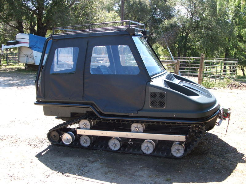

Here is one I redid a couple of years ago put a 27 hp kohler twin in it a the
McClaren tracks.
Also put a utv blade on it

Continuing with some work... Figured while there is another 45+ days before proper snow levels settle in the hills, I could do a quick restore on this Trackster.
Nothing major planned, but a little upgrade on some of the systems, like all new wiring (since original is all just toast, owner used house appliance extension cord to wire the lights & switches, 12v battery terminal wires are cracked, and story goes on)...
So this is what I'm going for...
with the way that high-center works on these tracked machines with short wheel base, I figured I better do a good stinger both front & back...
rollcage is not a must, but will be an extra support for overall cover, plus I'll have my canvas guy saw up a nice cover, that will keep me away from the wetness and excess wind if need be.
Windshield will have to be redone, and wiper installed most likely.
Rigid dually2s will be great for lighting (front/back as well).
Small roof rack to carry extra junk along with a rear basket.
4000lbs winch on a receiver will be very useful, having options of both front/back.
