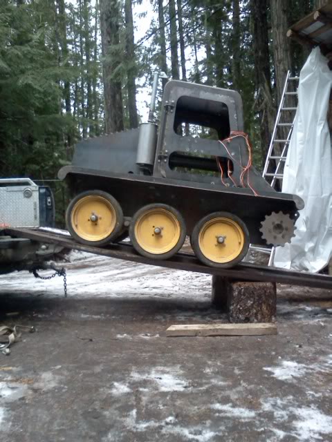

as the title states, i have a scratch built "bombi" which i call "the beast"
i didnt start the project and so far have not finished it yet, but getting closer.
its using an nissan a14 engine with a 4 speed manual tranny and what i believe to be a nissan/datsun rearend that has been narrowed down and flipped to get the right direction of travel since the whole drivetrain is mounted backwards from what it was originally in a car or truck.

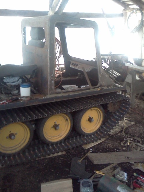

enjoy the build, and please leave comments or hints, tips or tricks either here or on the other forum. i am always looking for help, like right now with my tracks and how to keep them on the vehicle.

Looks good so far, about the tracks, it looks like to me that you need taller "keepers" on the inside. If you look at J5 bombi's you will see the exterior of the cleats are rounded to allow the tire to sit down into, and tall keepers inside.
Keep up the good work.
well, unfortunately taller keepers on the inside are not possible, as they would not fit past the brake rotor and caliper. but i am thinking that with 4 bolt heads per cleat i may be getting too much traction and be forcing the tracks off at every turn ecause the tracks don slide sideways enough.
so i am now modifying the track cleats. drilling larger hole on the outside and sinking the bolts inside the cleat.
73 cleats per track, 4 hole per cleat = lots of work lol
thanks for the encouragement, i will eventually get this thing to perform right.
