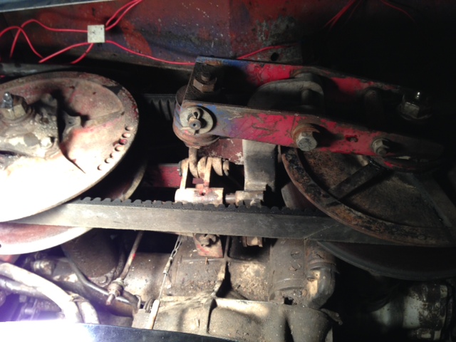

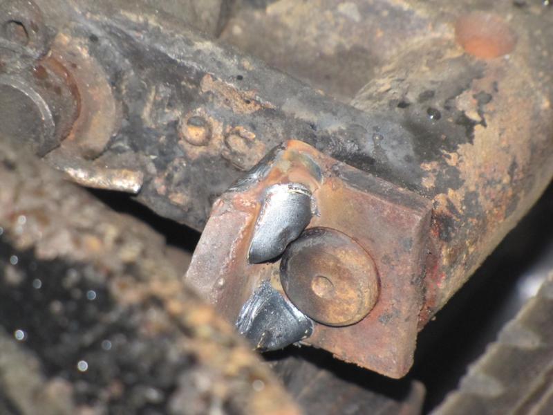

there appears to be a piston that slides in and out off this cylinder. Is the hole on top a missing grease nipple?
yes it is a grease hole but the pin is held in place by a bolt on the end. you can see it in your picture.the other end is fixed solid in a slot . this should not be pulled out but must swivel . is that large aluminum part broke or are you taking your steering apart?
i started on changing mine today. adjust it a little looser than the book says. if your steering wheel is centered the belt should be parellel to your firewall. yes the belt is way to loose. turn the nuts on the lower and upper springs but only a little at a time and both the same amount. if they are not the same you will turn more one way more and the belt will be larger on one end. if properly set your steering wheel will be centered and the belt will have the same diameter going over the shieves on both ends.
JimVT thanks for the replies. So... I am missing a grease nipple on that cylinder? I unscrewed one on the variator and tried to put it in, but the hole appears to be smaller. Not sure what you mean by broken aluminum. Here is a bigger picture of the Variator area. I removed the air duct so I could get to the bottom nut easier. 3 solid turns on both nuts and the belt seems to be in spec now. Next question.. on the air duct I have this fan motor. Is this supposed to be used for something? Seems that it would just suck in air from around the variators.
Also, track adjustment Nuts behind the back wheel. Do you know if its a 21MM Nut? I need to pick up a wrench.
Thanks for your help.

Thanks Nikos. I found the same manual and backed both nuts out counter-clockwise. Same turns on both. I think at this time I need start from scratch. Not sure if I should be clockwise or counter-clockwise at this point.
is that pin you showed in the first picture tight? If not it should be. loose you wont get your belt correctly set.i use a 11/8 to adjust the track nut bolts.
what ever you do don't run an over tight belt. you will brake that aluminum part ST125. you may want to check it if that pin is loose.

Wilson you are missing a part had to go look at mine and check it out i'm going to research a previous thread and put it up for you. you are going to have to find a welder to fab up the support for the other side that is missing and weld it up for you
couldn't find the post but i did still have the pic on my camra so here is a pic of what you are missing on that shaft.

Well, it appears that I am missing a part. The bracket is welded to the cyclinder as well as lower arm? Any harm in removing the nut that is holding the shaft to see if the shaft is frozen?

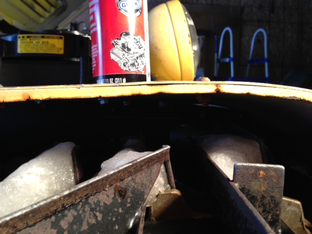

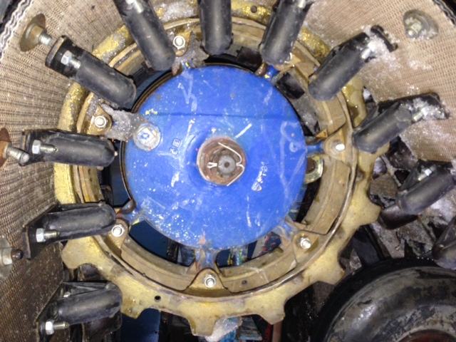

My other issue. Tracks... Left front track is about 1/2" below the fender apex of the sprocket. Right front is a good 3" below the fender at the apex.
Any ideas why this would be this way?

Take a pic of the front of the cat back far enough to get both front fenders to see if they are on the same plane?????

Wison, my guess is the shaft is free on your varriator but you can remove the bolt and slide the shaft out. but belt adjustment will be impossable until you get that new support angle back in place. if you have some one work the wheel a bit you can watch that shaft move up and down. as for your tracks hitting the fenders i don't know mine do some times but this happens a lot less since i did my big wheel conversion i'm thinking you don't have enough tension.
Don, JimVT is the bracket highlighted in yellow welded to the cylinder? Is the PIN highlighted in red the end of the bolt that slides in the cylinder? I will have to get this fabricated before I proceed.

I'm going to describe the best i can what you call a cylinder is a hinge that operates your varriator ,the pin slides in to the hole in red and is secured on the other side with a bolt. to dissassemble it you have to remove the bolt and slide the shaft out, the cylinder as you call it should have a grease fitting on it .the origional part was made from 2 pieces of flat bar weded together to form the angle i believe a much stronger piece could be made with a piece of 1/4 inch channel and an end mill than welded on to the varriator.
