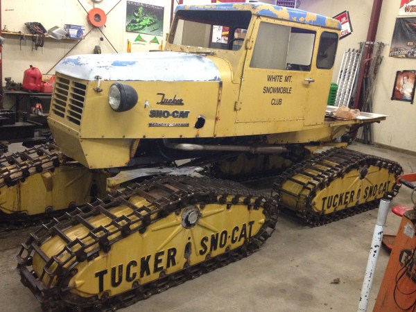

I am new to the forum and the lucky proud owner of a tucker 442. I will get some pics up soon.
The tucker is in great shape. Runs and drives nice no leaks or issues other than cosmetic that I can see. The tracks are in excellent shape and I just lubed all the rollers. The pontoon shoes still have some adjustment left.
It has a 283 small block chevy in it three speed manual.
One pontoon has been reinforced in the back where the axel goes through. Also on this one the outside tucker cap is differnt. Actually says sno cat 443 and does not have a grease fitting. Others have tucker on them with greas fittings. Also seems to be some gap shere the axel goes into these. Looking at pics on line they all seem to have some free play here. Is this normal?
What is the proper track tension?
ARe there any new shoes/skids available for he bottom?
Can a rookie do some basic fiberglass patches?
Where can I get some door hinges?
Thanks in advance. Looking forward to workin with you all on getting this back to mint.

Dont think it was the same one . No barn $2500. I reached out to him. His came from the next town over from me. There may be two still there. Sent a pm waiting to hear back.
Think I got it right this time. Let me know what you think.

Runs and drives very well. Every roller took grease. Have a whole bucket of extra track pieces. Fuel tank is being dropped off today to test repair. Some new floor, seats, backk deck, tool box, tune up and I am in business.

The slack comes from worn section pivots.
I would suggest contacting Davnet here in NH
as mentioned before. The guy is a resident expert on
Tucker steel tracks.
Let me know about the other sno-cats when you hear back.
Hugh

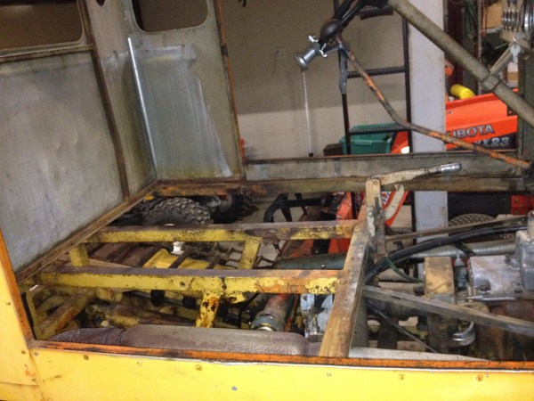

Thought I would update my progress.
Changed all fluids, plugs, wires, added electronic ignition, tune up, drain plugs for axels. All glass and doors removed for access.
Removed hydraulic control for rear. Don't need it for my application so I can add a bench seat to seat 3 instead.
Two steering hoses needed replacement. Welding a few holes here and there tonight. Dediced to go with tractor supply ac orange. Patching a few drill holes in the body and roof.
Diamond plate floor going in. Added some floor support. Power washed for ever and it will need one more before slapping paint on.

Looks like most of the channel iron is in good shape. A good cleaning and some paint will put you in good position for new floor. If all you have do is mostly cosmetic stuff you are lucky.
Looks to be a good, solid machine. Hopefully you won't find any surprises and make short work of it into a really nice machine! :clap:
