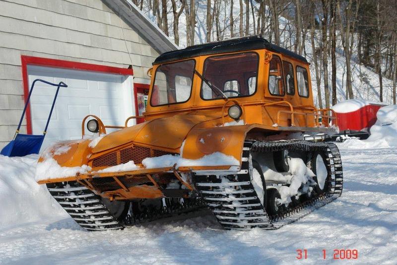

Enclosed the orange Snowtrrack image as it was when i bought it

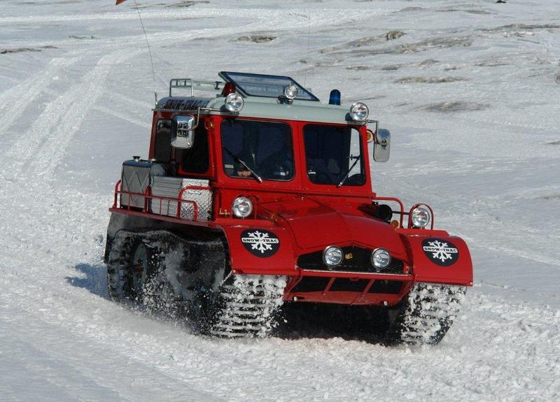

Now, let' talk about the full restauration I did: :smile:
New gaz tank custom made with a capacity of 20 gallons
Tires: big 4 new Alpine guide 16 ", 10 small new aircraft tailwheel , new bearings and seal on each wheel
110 track guide custom made to original shape and specifications
2 new custom made drive shafts installed with new bearings and seals
2 new drives splines bushing installed inside sprocket
New 2000cc engine installed
New exhaust system custom made
Transmisison overhauled and installed with new rubber mount
New custom made 16 teeth sprockets at transmisison output and new chain installed
Variators overhauled with new strap, bearings and seals
All electrical renew: new battery box installed outside, new wiring, master switch, lights
2 new independant wiper motor and mechanism installed
Gaz heater overhauled;new gaz pump and gas tank
New paint (red, my favorite colour) and sound profing
New custom jump seat install
New brake system all over
I could drive it a few times on the St-Laurence River shore but I might be missing snow very soon :sad:

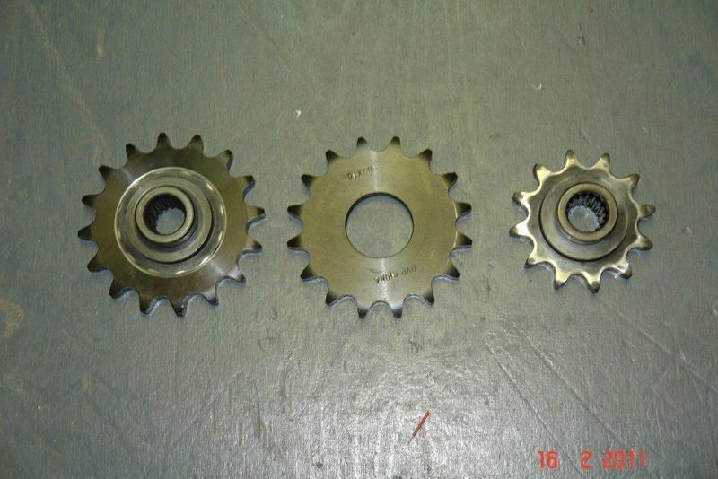

Good job with it. May I ask how if you know what kind of speed the 16 tooth drivers gets you? It is something I would like to do with mine.

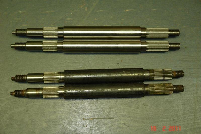

i would like to find out about the drive splines you had made. this is a part we cant get anymore.
jim

The speed with the 16 tooth give a very nice cruise speed in 3rd gear
3200 R.P.M. (18 to 20 M.P.H)
4200 R.P.M. (25 M.P.H.) and you still have the 4th gear
(image gear 1 and image gear 2)
The 2 new drive shaft made in a machine shop in Quebec city cost 1,900$ CAN$ with the splines drive inside the sprocket (see image shaft)

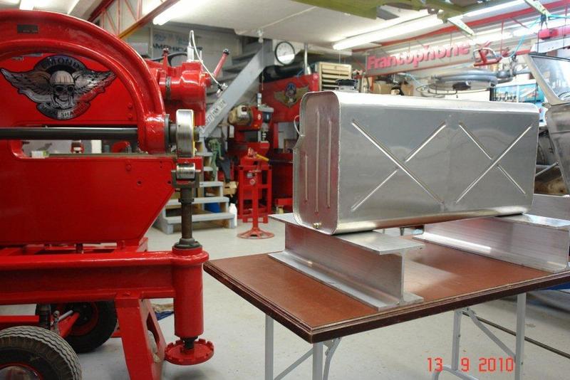

To build an aluminium gaz tank like the one you see on my Snowtrack requires :
A Pull Max
English wheel and many sheets metal tools
Welder with lots of experience (I am certified Aircraft welder with 30 years of experience )
(image gaz tank 1 and gas tank 2)

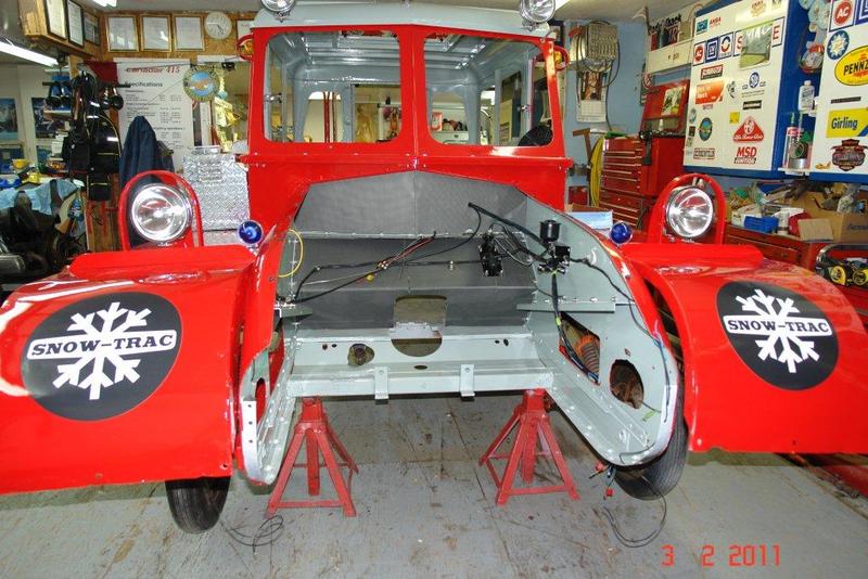

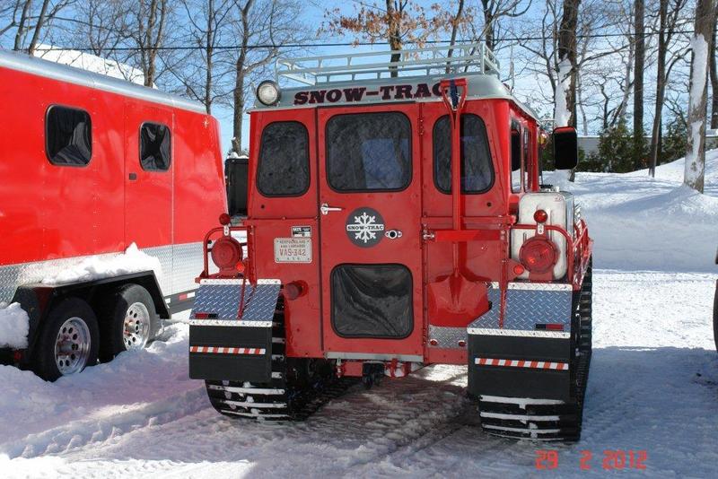

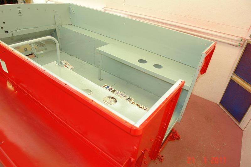

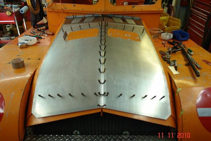

Hi,
Additional steps of my project
Picture 1:
The old hood was in a very bad shape so faster to make a new one from scrach (aluminium 2024T3 063")
Picture 2:
Inside new hood ready for final paint
Picture 3:
Engine bay before repair and paint
Picture 4:
Engine bay with new paint
Picture 5:
Cabine ready for final paint
Picture 6:
Engine bay with noise cancelling "DYNAMAT" installed
Picture 7:
Sound proofing material installed (Jig saw closed cell .500" foam) installed over "DYNAMAT" with HD contact glue
More to come!!!! :wink:
I'm just curious, when you are done and have some free time, my Snow Trac needs to be freshened up a bit, it was restored about 6 or 7 years ago, could use some work again. Stop by, I'll let you use my tools to fix it up for me . . . won't even charge you to use them.
Here are picture one to 7

The 16 th tooth gear is the way to go :smile:
So, built one from the 12th tooth you already have like i did; it cost me less than 25.00 CDN$ each for material only.
We are in Quebec at the end of the winter season :neutral: Snow is not good now
The 4th gear at:
3200 RPM (28 mph)
4200 RPM (33 mph)
4500 RPM (35+ mph)
Requires a strong engine (95HP +) in 4ht gear in bad spring snow conditions

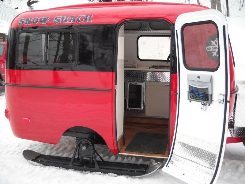

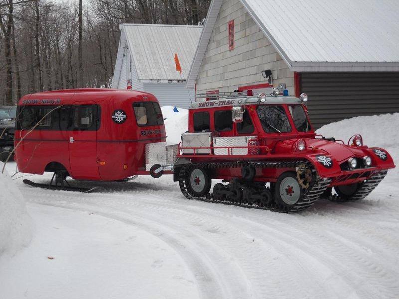

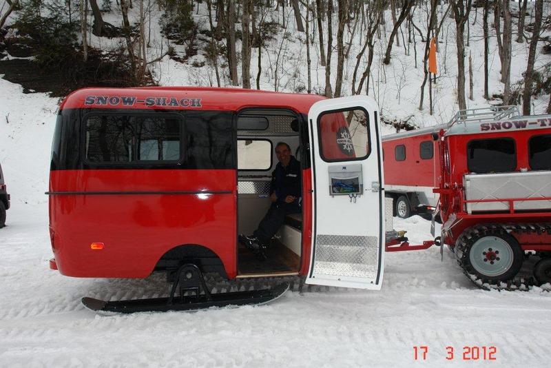

Hi guys,
I have found an original snowshack to complete my set of snowtrack and snowschack
Now, i have the SUPER MEGA FULL WINTER TOY KIT :clap::wow:

Short video on my SUPER MEGA FULL TOYS
[ame="http://www.youtube.com/watch?v=ozsq2QGkl_o&feature=channel"]Snow track Quebec Snowshack 1 - YouTube[/ame]
Second short video with my SUPER MEGA FULL TOYS with all lights on !! :w00t2:
[ame="http://www.youtube.com/watch?v=LyRUgihsDeA"]Snow track Quebec snowshack 2 - YouTube[/ame]

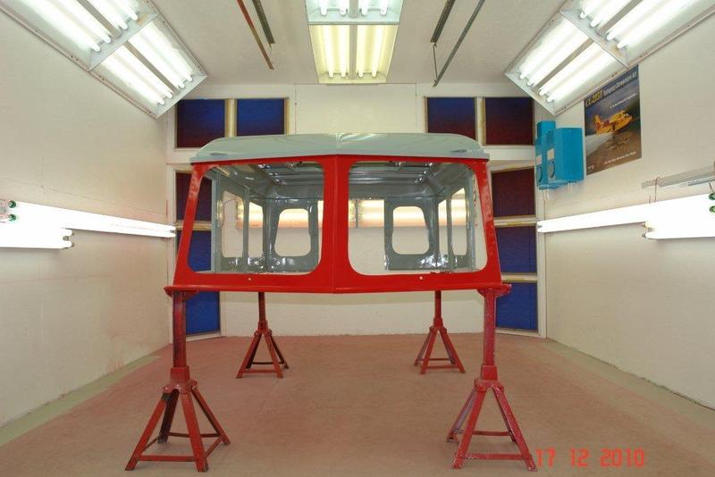

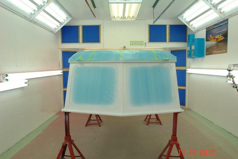

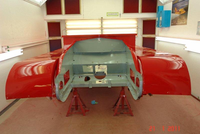

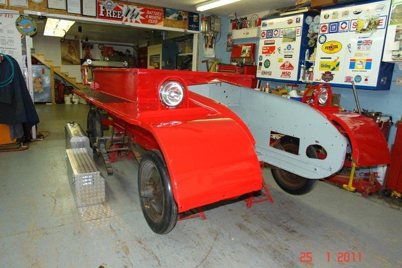

Hi,
Additionnal pictures of my restauration project during the paint process
More to come...:smile:

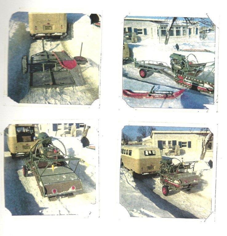

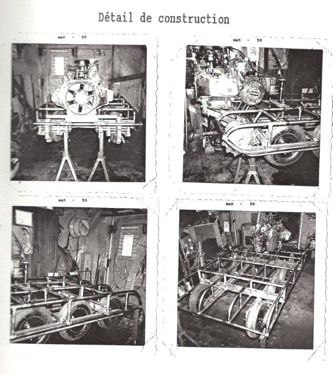

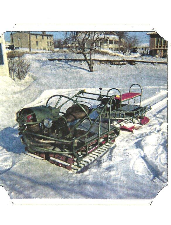

Hi guys,
Speaking of homemade type Snowcats, here are some pictures of my father's builts in the late fifties
1. First articulated vehicle (1958)
2. Citroen 2 Chevaux engine tractor 1959
3. Citroen Engine tractor construction details
4. Second articlulated vehicle with Jawa Bike engine (1960)
5. Jawa with multi function trailer

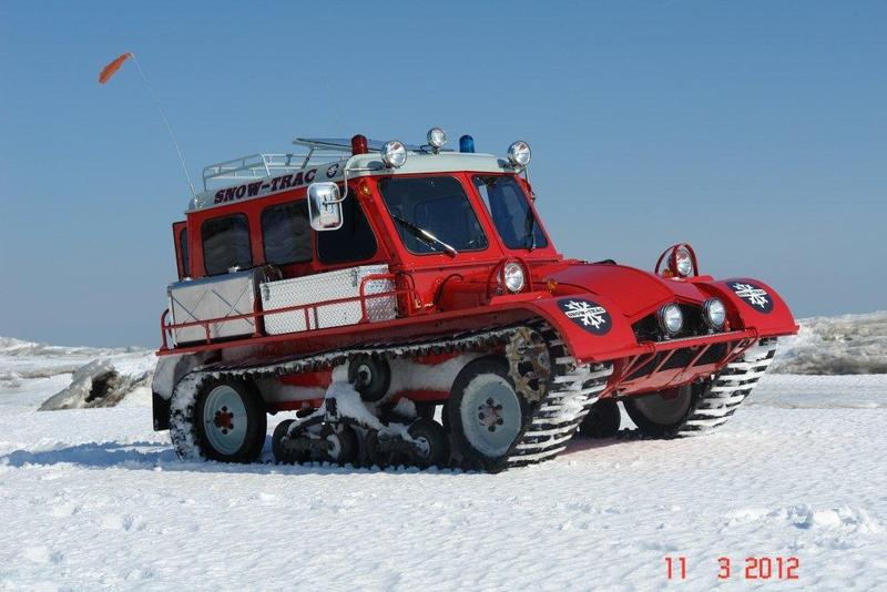

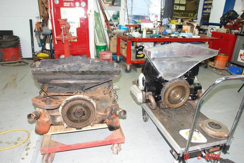

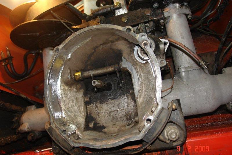

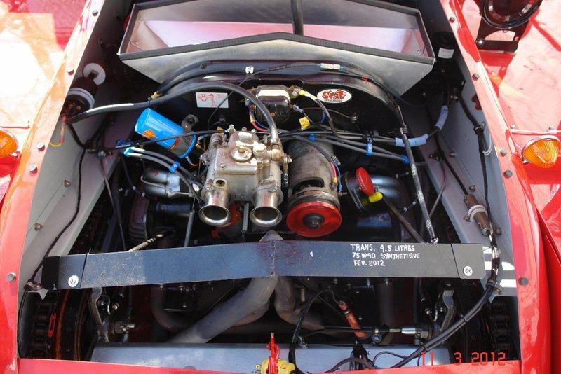

Hi,

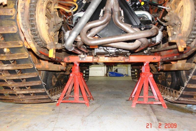

Before the full restauration of the snowtrack, i've installed the big engine and tested everything; new exhaust, new intake engine cooling duct, exhaust baffles, throttle and clutch mechanisms
Picture 1:
I had to grind out the transaxle housing for flywheel gear clearance
Installed a new starter with the correct gear
Replaced the starter bushing in the transaxle housing to fit the new starter
Picture 2:

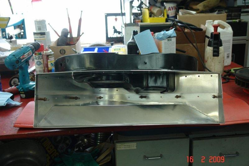

As you can see, the bigger 8 dowels VW flywheels, the bigger 1 7/8 diameter 4-into-1 exhaust system
New custom cooling air intake for the big engine
Picture 3: Custom air intake duct fit over the oil cooler
Picture 4: Exhaust system routing and some exhaust baffles
Now, Quiz time? :smile:
What do you see on picture 4 that you can also see on the picture (previous post) of my dad's vehicle made back in the fifties?
More to come...
