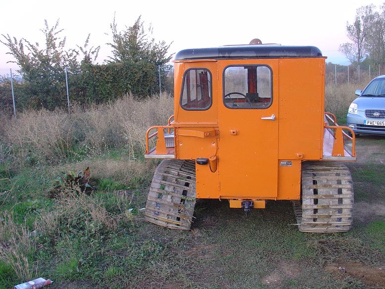

As a new owner of Snow Trac from North West Greece in a small town Florina, hello everybody in the Forum.:w00t2:
Nikolaos Speaking.:biggrin: I bought a Snow Trac ST4 1503, (1971 year) so i began to rest orate, and i need help and advise. My Snow trac is Running, mechanically is in good condition.
This Snow Trac it belong to an Electricity Company here in Greece, until 1980.

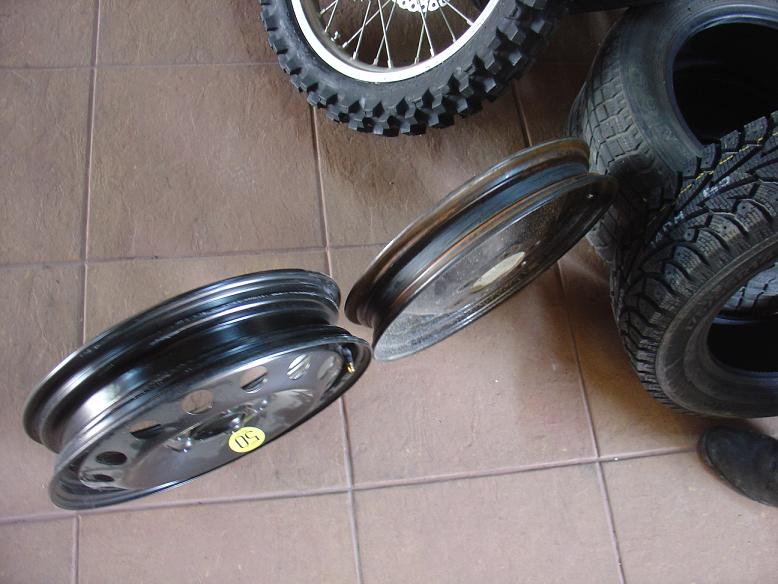

Fist the rear wheel is completely damaged, so i need one new, or used but in good condition Trelleborg 600X 100 6 ply (Tire and tube).
I need also 4 boogie wheels Trelleborg 400X 4 6ply (Tire and Tube).
Can somebody tell me if where can i find the parts.
If i don't find anything, the Aero Classic 400X4,1, (for the small ones) and the Good Year 4,5 X 1,6 NHS 6 ply, or the Alpine 4,5 X16 (For the large Wheel) are the right type of wheels for the SNOW TRAC.
Next step is to replace the 3 section design trac with the large wheel. I need a dimensional drawing pattern- for the crawler tracks.
The elastic belts how many reinforced inserts must have?
regards nicktam

on the rear tires you can use a street tread motorcycle tire the composit wheels are a motor cycle rim with an aluminum slug installed the little tires are aircraft tail wheel sizes good luck nice looking st that one has the ambulance door in the rear

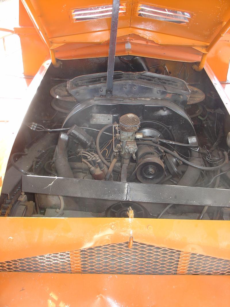

I noticed the lack of vents in the engine hood .Fist one I've seen .
Jim
nikos
dds and JimVT Look at the pic. The vents for engine hood for the air to cool the machine, are in the front, in the same place as the others ST4.
The last pics because the sun light, (no shadows) we can,t see the shapes with the different forms of the vents.
The designer has change the way of travel air from the vents.:hammer:
The way of the air is oposit, in front the windows.
Here is the pic with the machine and the vents from inside.:unsure:
Any question?

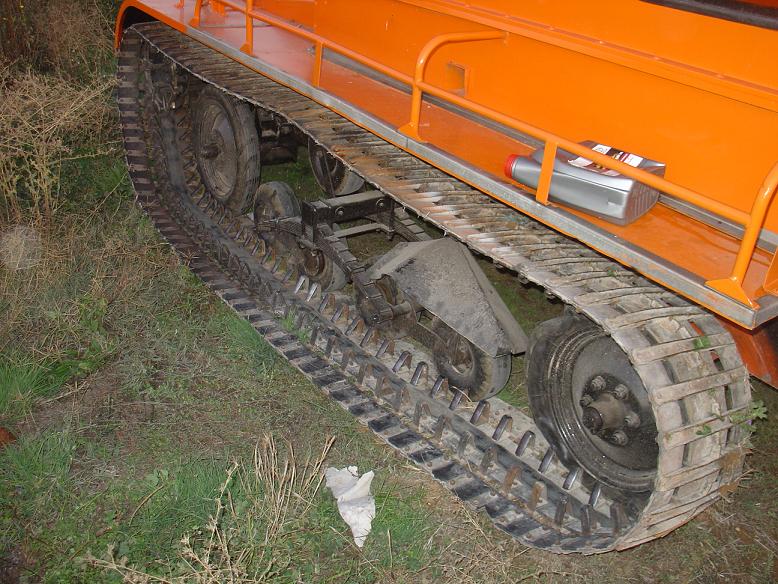

First lay out the belts and i try to change- replace the track belt.
I think the big problem is there, with the 480 holes per side:hammer:, and also how many reinforced inserts must have the elastic belt

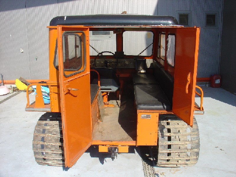

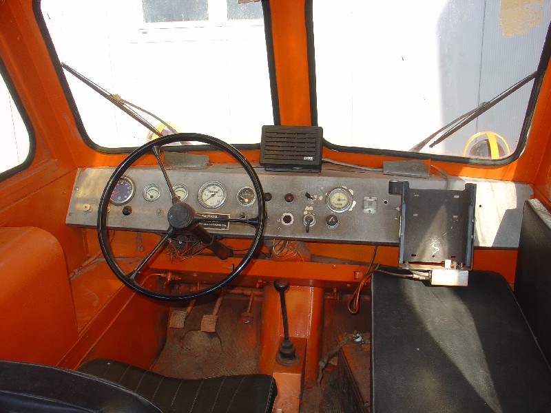

I send Pics to see some others differences (doors - instruments , lock case e.t.c).
The glass of the Window is in the floor, because the case infront of the door was broken and the door open from inside (open Window).

I noticed you still have the gas heater. Most of us have scrapped them.

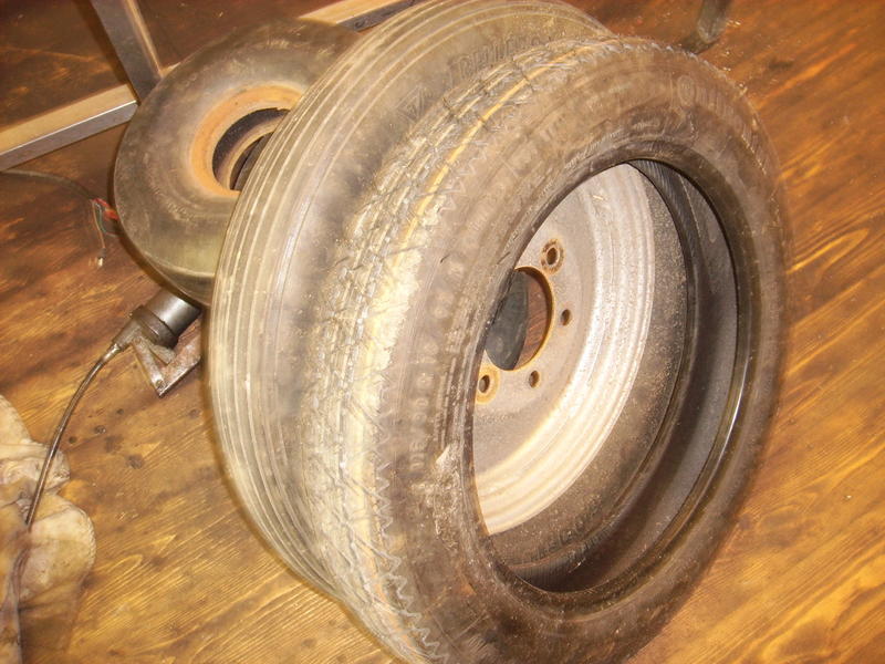

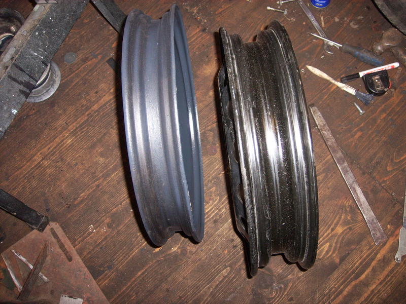

in this pic we can see the rear flat tire in ST4. The previous owner put on a motorcicle Wheel (no insert and ply reinforced) and thats why the tire was completly damaged.
Can someone tell me about where can i find original Trelleborg 600X100 ?
OR informations How it works (the size between tire- rim) in
a) the Alpine Guide 4,5 X16 6 PLY
b) Goodyear 4,5 X16 NHS 6 PLY
c) Continental T9 SIZE 4.00 -16 AS Front.
Are these types of tires right for the ST4 ? Any address and post?
what about the composit wheel, any informations ?

to the best of my knowlage none of the 6 bolt wheels were composite you are better off with the steel wheels

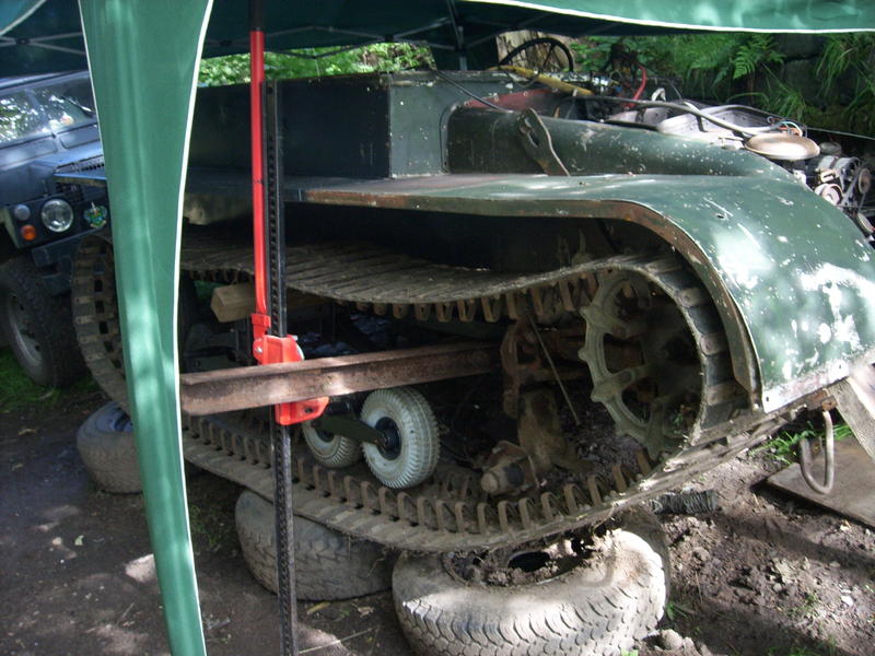

hi Nikos i have st4/1575.had no look finding correct tires.but have fitted two tires at the back. off BMW space saver spare wheel.continental 115/90/16. these are only single ply.but run high psi.cheep at scrap yards maybe better hard foam filled.most of weight is on the front wheels.i fitted puncher proof mobility scooter tires also cheep second hand.ps Iam in England.
nikos
Hi Jim :clap::Great idea:clap::clap:
10 points for England:clap::clap:really !!!!!!!!! for your suggestion.You are great on.

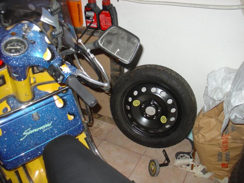

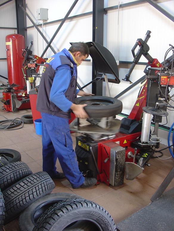

Look what i find in my garage:w00t2: :w00t2:A BMW continental 115/90/16:yum: :yum: Now i have to buy another one for the other rear side, and then i replace the original Trelleborg. Olny to have a back up, if something happent in the Front wheels.:w00t2:
Next step is to foam fill both of the 115/90 continentnal tires.
Thanks again JIM. Your opinion was so appreciable:clap::clap:

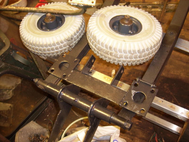

Jim, if you pleased sent me a pic of yours small boogie tires, (to see the type scooter foam fill tires). I have a close relation with the scooters as you can see.

What BMW is that wheel out of? It looks like it may be a good one to modify to use on my snowtrac.

Jim VT sorry for the misunderstanding, i ask SnowTracJIM from England to send me a pic of his Army ST4 (with the boogie scooter foam fill Wheels). If you read the threads below, you can see the facts. Also the congratulations :clap::clap: are for everybody here in this Forum, because the level of the Knowledge and the experience that we share out, is the basic cause of this interactive approach, for the progress - Restoration and presentation of the projects in Snow cats.
But Jim VT the BMW foam fill Wheel is a very good solution, because you can find this product - TIRES everywhere, in any country with BMW cars. I think this tire has 3 ply, and it's run in high speed. Thats why i ask Snowtrack JIM to sent pictures to see the total instalation in his Army ST4 in England.
HI NIKOS hope these are of use.Iam not very good with computa only got one at beginning of year.400x4 tires are off disabilaty electric scooter.the pic of rims are st/4 and BMW.I will get size of stud paten for Jim vt tomorow.think early snow tracs have 5 studs on wheel.

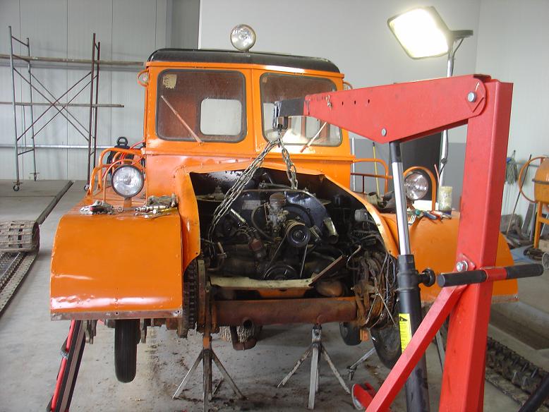

Hi guys. After a couple a days in silense (Watching- Searching - Learning- wondering in F.F) here i am again. The fist snow in the mountain:clap:. So we better hurry.:hammer:
LYNDON ... you are right. Look what had happend when i deside to drιve move ahead the ST4 in the garage. :yum:
After a few minutes we put the wheels inside the drivers, and this time with reverse the ST4 arrived in the garage.:w00t2:

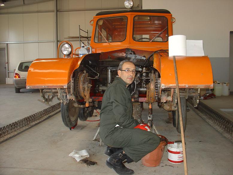

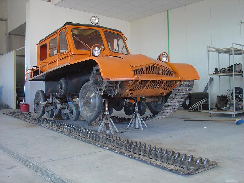

nikos
dds this Shop building it is a place close to the National highway 5th Km Greece to Former Yugoslavia, and it belogs to a close friend of mine. Its not only a vehicle workshop - servise auto, but also a place for Washing cars, for spare parts warehouse, reprensative car factory, tires, etc.
In the building in which i had parked the ST4 its was a warehouse for tructors, farmer vagons, and smal trucks.
The operation its just began,:hammer: tires, mechanical parts, Lay out the belts.
Here i am Guys. Nikos in my workshop measuring the holes in 3 schematic belts. Lets Rock n Roll, Good Luck, and hope God on our side.:biggrin:

puting the tracks on in the air will be hard when you go to put then on uou will want tto be sitting in the tracks than you will want to pull th etop track over to the drive sproket use the starter motor to turn the drive sproket to pull th etracks together than bolt them up it's also how i break them apart also you bear a strong likeness to one of our local preachers good luck

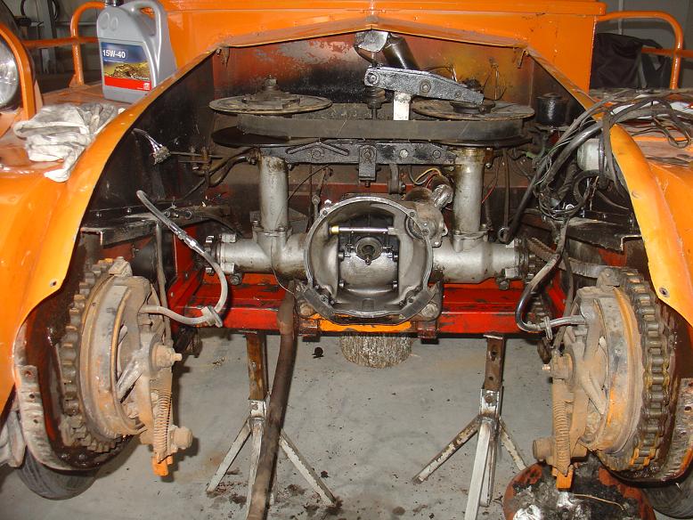

As I am waiting the varriator Belt to be replaced and some gaskets,i am trying to rebuilt the floor - inside and under the frame (probably to found any rust - priming- painting etc).
