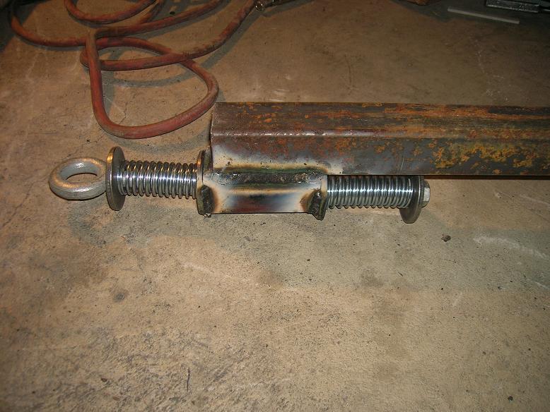

The sled I built could haul up to at least 2,000 pounds of lumber and supplies. When I built it, I made the ski stance the same as the snowmachine so that I didn't have to break trail twice. It is light and I used it behind both the snow machine and the Thiokol Imp. Here is some photos of it during the construction and a video of it carrying about 1,000 pounds of lumber (or more).
[ame="http://www.youtube.com/watch?v=1bfo_mbUGX0"]Hauling cabin building supplies - YouTube[/ame]
If your interested, you can either come see it or just use the idea of it to make your own. It has been replicated a number of times now by other guys wanting to haul freight.

Thanks Fogtender I will be able to finish mine now. You had explained it before but the pictures really help with the pivot detail. I am going to loose the springs before I go any further. Again grateful Kapkichi
